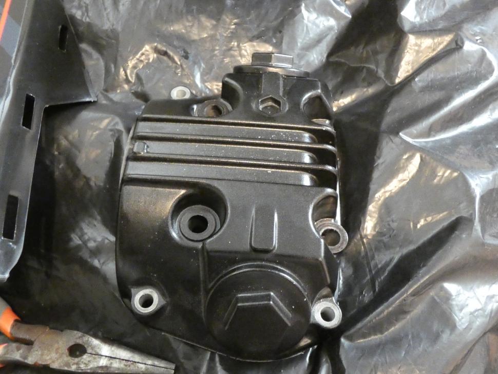

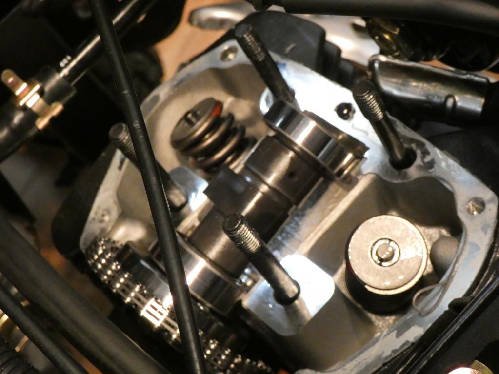

I just did my friends 2018 bashan storm valve adjustment so I figured since I have to do it soon anyway why not adjust the valves on my apollo deluxe. Its very different might I add. for the bashan I just took the top off by the 4 bolts then the valves were exposed for adjustments. On the apollo its not quite like that and I need some help LOL Ill post some pictures. The top came off after undoing about 8 bolts between the top and side but now its just open, not sure how to adjust from here.

You need to put back on what you took off, and properly retorque it! You're one nut and a cam chain away from removing the entire head. Do you see those hex shaped plugs on what you removed? Those are the valve adjustment caps for an ohc motor. You basically half disassembled the head. You'll also need to clean off both of the surfaces gently with a razor blade, then reapply Honda/yamabond, so that it doesn't leak oil.

Thanks! oops! alright im on it! thanks for the quick response. It was very hard to even see the valves when I tried to look through those two small holes, I could barely get my feeler gauge in there! haha But alright im gonna go ahead and put all this stuff back on.

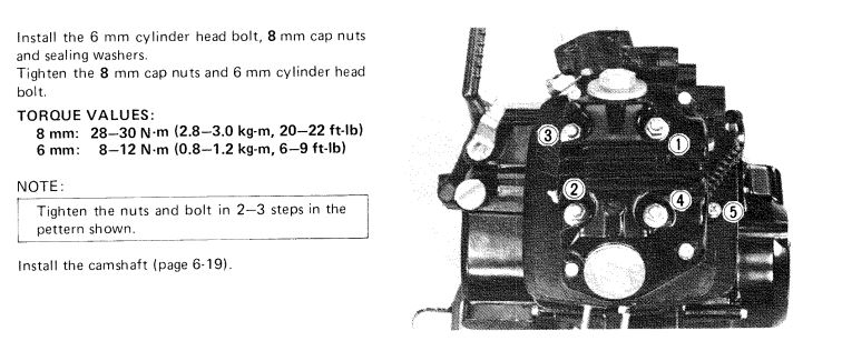

Nope, you bought the wrong thing. It's a grey semi drying silicone, normally called Yamabond or Hondabond. Regular silicone isn't used because it isn't as effective for these close tolerances. Do you have the torque specs and order of tightening the bolts? This is precision stuff.
Old 02-19-2020, 03:58 PM   #9
Here are Honda specs.

Yeah I know I messed up haha Im not losing any sleep over it, I have learned from it more than a few things. I already have all the tools I need, Im just waiting for the Hondabond HT to get here. Jerryhawk250 sent me some honda ohc specs as well which I was thankful for. I have already cleaned off both faces of the cover properly. Just waiting to be sealed and closed back up! I am hoping no leaks happen but I am taking my time so i dont think any leaking will happen. Wont know for sure until I start the bike up for the first time when the weather breaks in about 3 months. Im following all the torque specs sealing the gasket properly and hoping for the best. When I took the cover off, nothing else came out or moved, just the cover.
