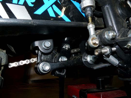

Drilling new rear shock mounting holes worked.
The linkage adapts to shock length, but note that it appears to be linear.
More info here.
https://www.chinariders.net/showthre...t=31439&page=4
I will post photos of finished height once I finish the other work I am doing on the carb and wiring. Work is LOOMING since it is Monday. Crap.

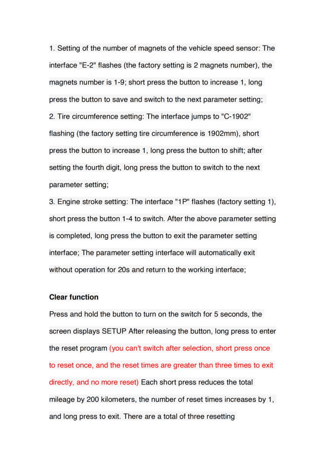

I could use a little guidance... Mine is set to 2182, but my MPH is way off. Just used GPS and at 25MPH, the speedometer is only showing 9MPH.
Anyone have any ideas?

Looking for a little help with the speedo setup, base Templar non X model. It only has a single button and pgm mode only has three circumference settings: 2182, 1795 & 1522. Can’t remember where but 2114 was the number for the 21 front. The unit appears to be a SHKALACAR https://www.amazon.com/Shkalacar-Mot...sal-Tachometer

I LOST TRACK of the instructions on how to switch between kph and mph. Was it hold button and switch on?
Also, how do you select the 21" wheel code?
By the way... I am going to crank up the rear shock preload and give this 4" lowering a whirl. It is reversible (just mount back to OEM slot!), so no harm in trying. And I am unfortunately approaching geriatric joints and tendon strength, so no big whoops and jumps for me
With the speedometer on the odometer screen, press the button to switch from KPH to MPH.
To select the wheel code/circumference, turn off the key, hold down button while turning the key back on. I can then choose from 3 preset numbers...
The attached image is what I thought were the instructions, but mine does not work like this or I cannot figure it out. The only part that works is the beginning 'Enter to setting mode:'...

Thank you!

I have some Chinese-English instructions I found on AliExpress that is different but the image of the digital dash they were selling was the same. It may have some additional details that might help program these dash units.
Excuse the images, I figure folks want the full resolution images to see details properly so I have included those in the zip file along with Autodesk drawing and Connector photos and Wire Connection Specifications. The text is actually just image files so I couldn't do a simple copy/paste here.

These universal digital dash motorcycle units all look the same but I have found a third variation. This video is in Portuguese so you need to set YouTube video settings to auto-translate to English so you can read the text while the person speaks Portuguese. I hope there aren't more variations. One of these videos should match.
Old 12-25-2022, 12:09 AM   #939
And it's neither! It seems to be a fourth variant. It's as if one company made the universal dash shell and every other company made the electronics inside to run it and tossed it to the market as their product.
I went to the garage and gave myself a few minutes before the cold seeped through me to play with entering setup mode. It's simply hold the button down with key off and turn the key to on while holding the button down. My dash had a large number and four smaller numbers. The large number was not changeable. Clicking the button clicked through about three preset settings in millimeters for the four numbers section of the display and a very short timer of no button presses switched the display back to the normal dash mode from setup mode.
So the bottom line if I want to fine tune the millimeters to dial in an accurate speed reading I buy one of the three universal dash units in the three videos above. I have not tested my dash against gps to see how far off the displayed speed is. How much the speed is off from actual speed would likely influence any decision to get a new dash or just live with it.
