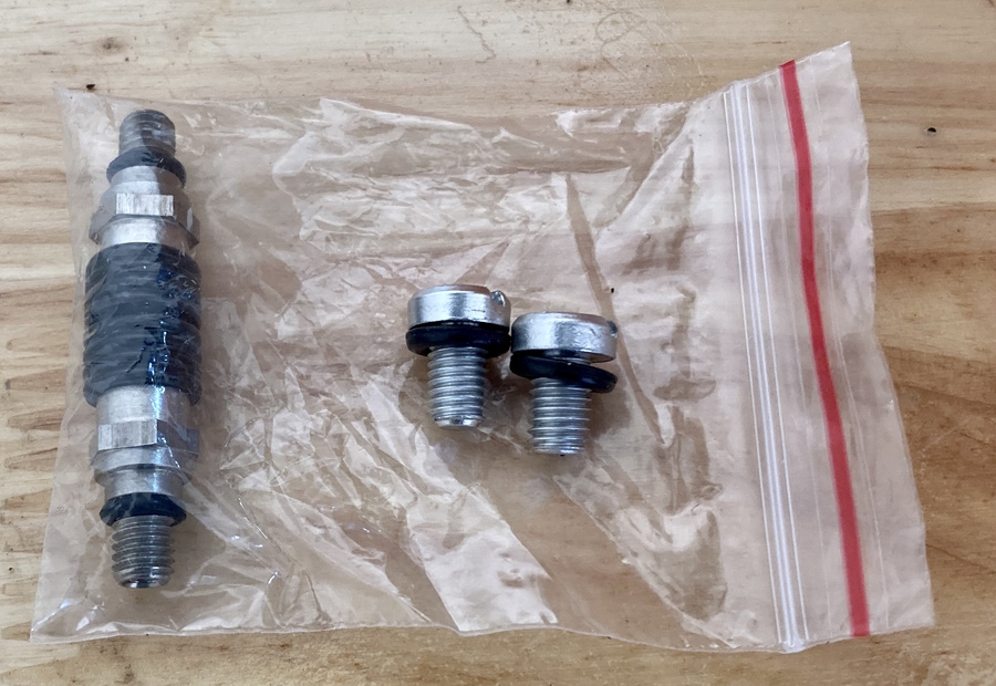

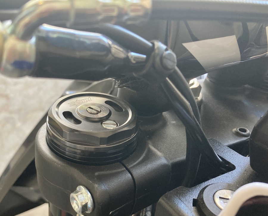

I was not planning on doing this early on, but I had a set of these from AliExpress in flight and it just so happened to beat my other AliExpress parts order from arriving so on with the install!
Before, you can see the air bleeder screw on top of the forks, its not good accessibility, not poor but having to keep a large flat bladed screw driver on hand to manually bleed the forks and equalize the pressure can be a pain if you need to always carry tools with you.
Before picture is viewing from the front of the bike.

New parts and the old screws removed side-by-side

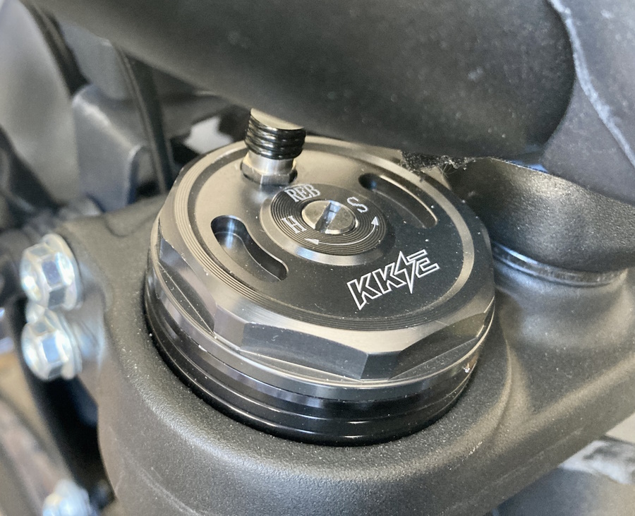

And after, now just pushing down the valve with your finger will let the air pressure equalize.

One thing I noticed, is the screws uses a much wider o-ring for the seal. I held down the front brake and put all my weight on the front fork compressing them and listened and with the tiny o-rings I could hear a little bit of air burbling, so now I tried swapping the old o-rings on to the new air bleeder valves.
After picture is viewing from the back of the bike while seated.

Reinstalled the bleeders and put my weight back on the front forks compressing them. No more burbling! This job is done.
I will test ride them for a while before deciding to leave them on. I want to see how well their seals hold up over time with many compression cycles on the forks. If they still allow compressing with no air escape burbling noises then they can stay. If not I will try another style or go back the the screws.
You did remember to put your screws in the bag the valves came in and put them away in your parts drawer yes?
