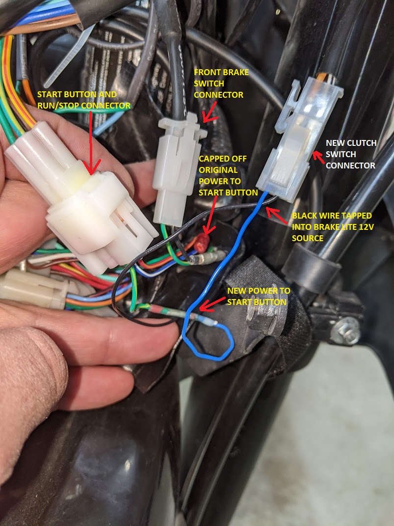

This is 100% verified and correct. Along with the lack of a full wiring diagram, the brake starter interlock is one of the biggest annoyances on the Templar-X. I have modified mine with a new clutch lever that incorporates a switch and rewired the interlock circuit. Attached are simplified diagrams of both stock and modified circuits and the OTOM OUDIMO-58958 clutch lever kit I used. It comes with a spare clutch cable and choke cable and is currently bargain priced on amazon. OUDIMO-58958
Also attached are photos of the relevant original neck harness wiring.

Here is a photo of my modified neck harness wiring.
