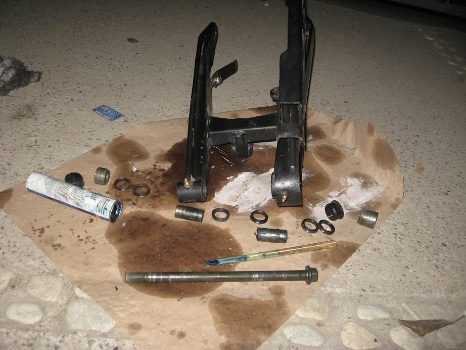

Removed, cleaned and greased.
all the rear linkage. on my italika DM150(same as some others i cant think of at the moment).Originaly it had real nice needle bearing and good quality grease seals. grease zerks,(but totally inacsessable). there was one link that had a hole drilled but no grease fitting in it. it packed with mud. i cleaned and glued it shut because i dont have thread tappers.

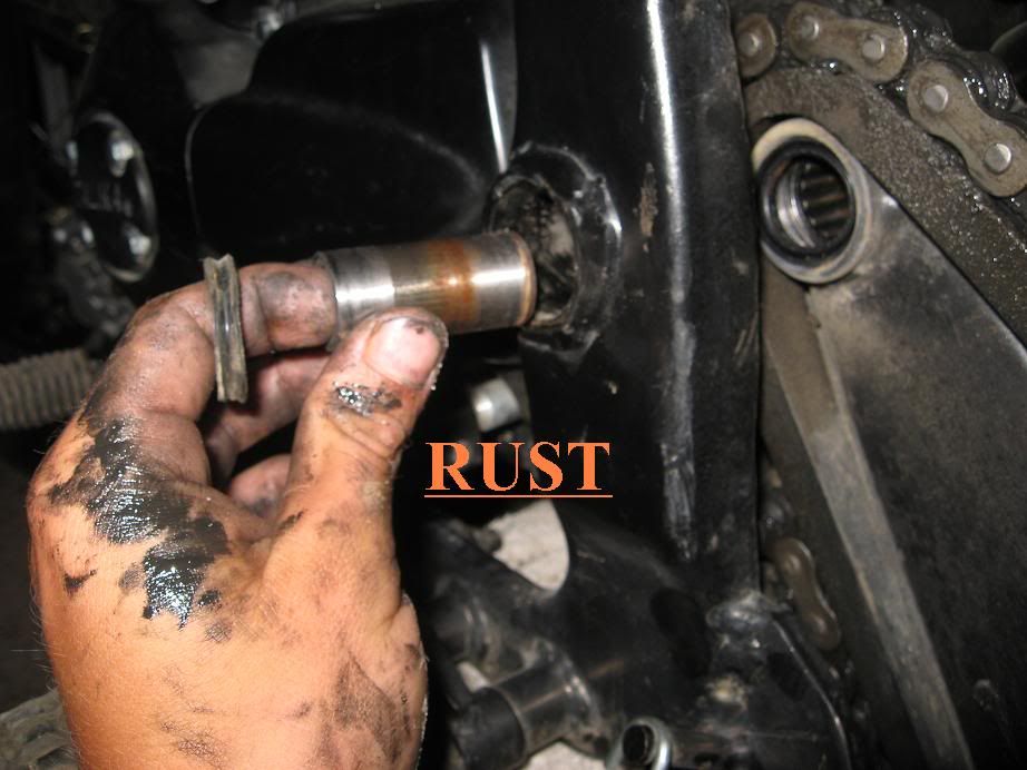

i packed it with some HIGH dollar marine grease i had left over from work . (i am at 1150km 2.5 months), mostly highway and small town roads/trails the needle bearings were rusted pretty bad already. but just barely saveable.
I was impressed by the build quality of everything i seen. it was all top notch design and materials. just crappy assembly. the swing arm was surprisingly light, i guess 5 lb max. but the tire/wheel was about 12lb. they had a oring piched betweeen a spacer, lock washers in the wrong order. using washers in the wrong places and not having them it the right ones. all major bolts were metric grade 8.8!! but some of the holes in the linkage were 1mm too big and i have about 1" of free vertical play with the bike on blocks is that a problem", or just a nuisance?

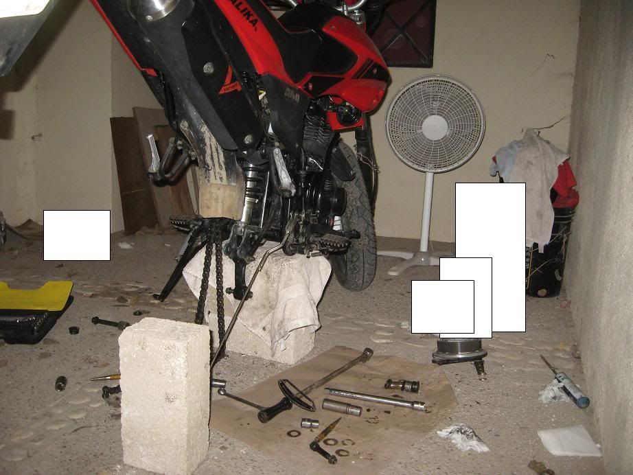

Here , have some pictures.
THIS is the order that things go back on. i had to take it back appart because i reslised after loading the pics to the computer

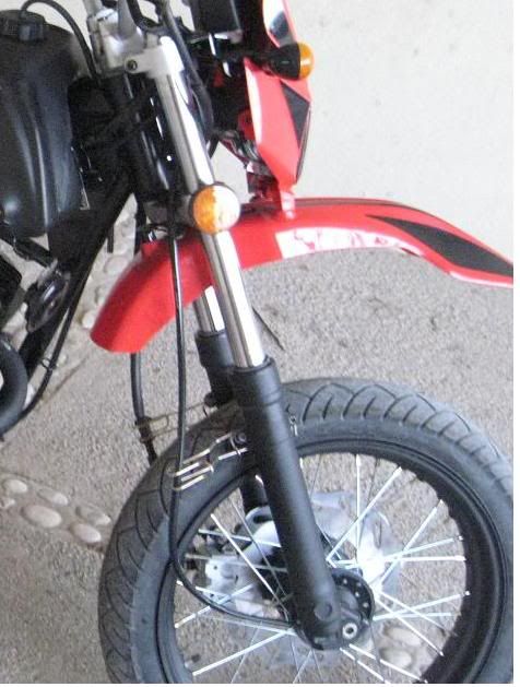

CAN ANYONE ID THESE FORKS?I can take measurements soon.

The free play comes from the 2 silver link/plates that go between the shock,swingarm and frame.it is hanging from the shick in picture # 3. the holes are just a tad too big. but the bolts fit perfect in the bushings/bearings.and one is just a 1/2mm too long. I think i my have a new link made and make it to where my suspension is softer because im 130lb naked, maybe 145 with all gear.
