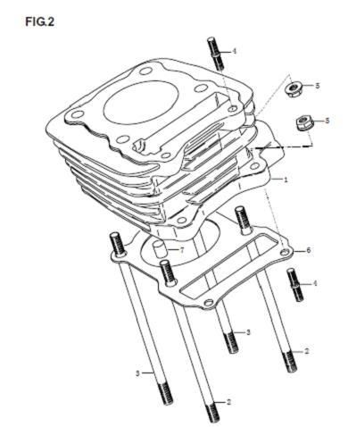

In my galley you can find several pictures of the engine including an "cut open" one.
They are identical to the Suzuki engine (at least the -06 model) some minor changes are made on the -07 model.
Only difference I've found is that Qingqi uses 428 chain, and a slightly different Mikuni carburetor.
I can send you a complete file of Qingqi engine part diagrams (of the whole bike if you like) so you can compare with Suzukis (Alpha sports for example has online parts diagrams) The bikes themselves differ on various parts but a lot are the same..

Posts: 304
Example:
Suzuki
Qingqi
