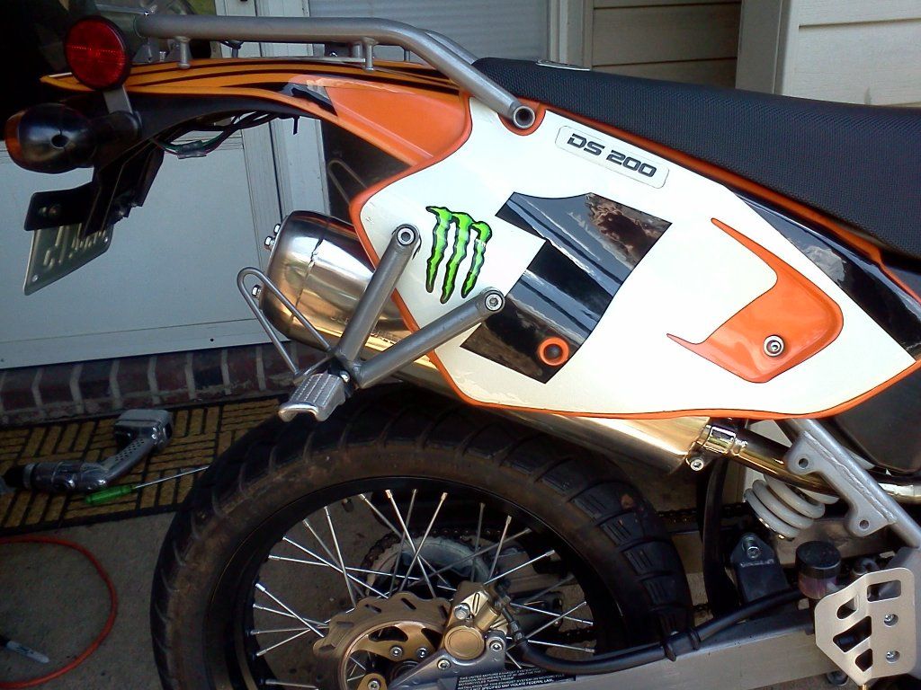

Okay, jokes over. I have been looking around for a way to keep my nylon bags from getting cooked by the muffler, and I had some really nice ideas of different brackets I could fabricate, and looked at some pretty expensive turnkey solutions as well.
But I was standing there staring at the bike this morning, and it hit me like a flash.

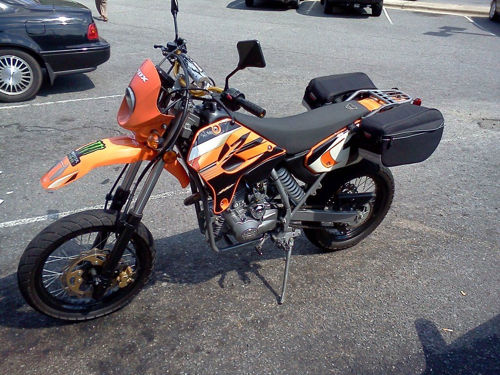

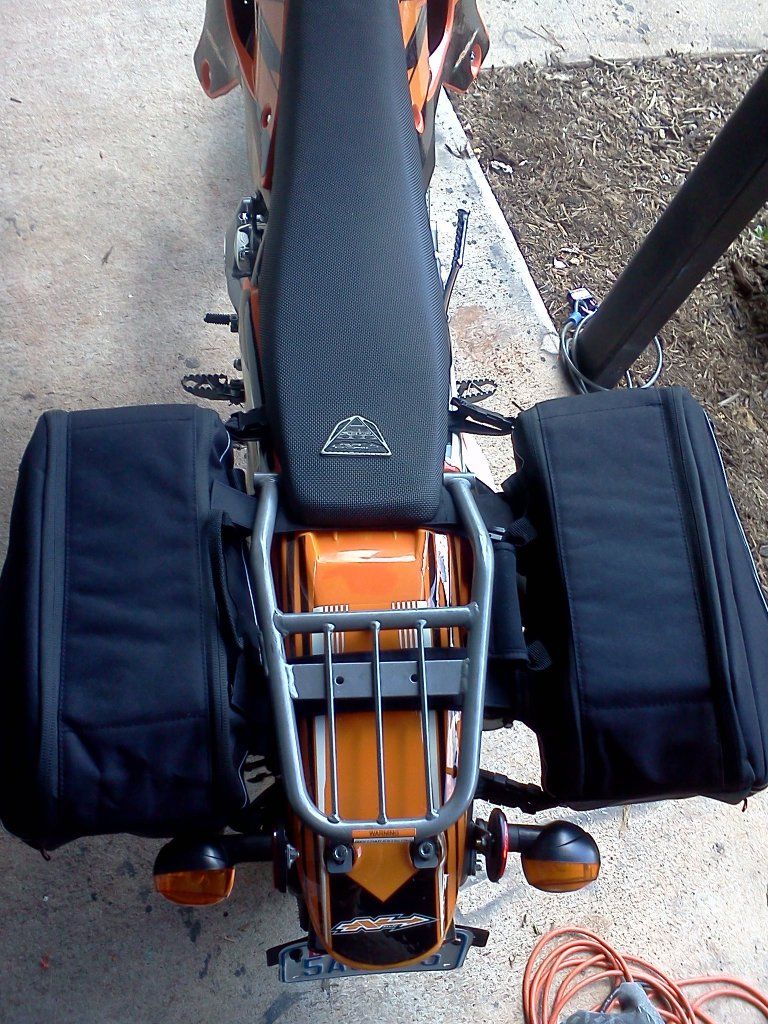

Moving the passenger pegs up to the right place would keep the right bag off of the exhaust, and also allow the bottom of the bag to rest on it. It does three things; it keeps the bag off of the exhaust, it provides a rigid back for both bags so they don't flop around going down the road, and the bottom of the bag rests on the surface of the peg, giving it sort of an L bracket in the inside and bottom of the bag.
And I only had to drill 4 holes and do some light diss-assembly to mount the bags in a permanent and nicely stable way.

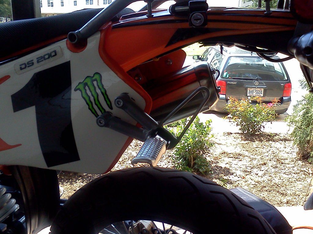

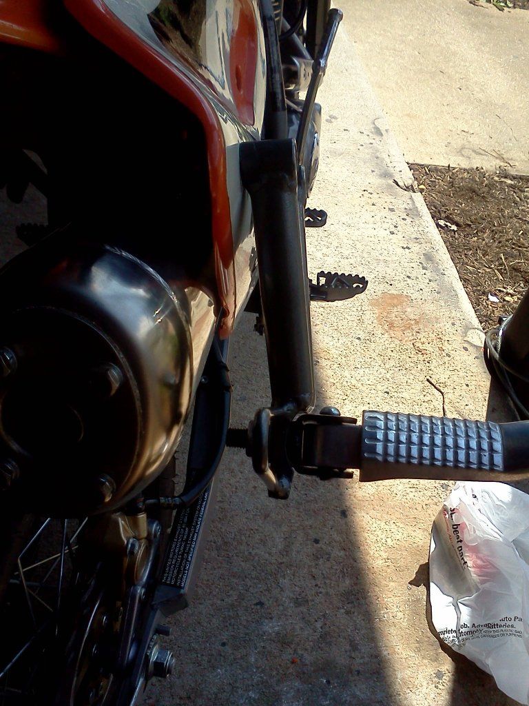

Check it out. The big bolt that holds the peg on its bracket rests on the muffler when the bag is loaded, keeping it safely off of the hot metal, and letting air still get to it.
Took the seat and the rack off to mount the bags nice and tight.
The end result is pretty darn nice, and very stable. I'm going to get some velcro strips and put two pieces next to the pegs on the bottom of the bag, and then strap one over the bottom of the peg to hold the bag to the peg even better. I'll post some pics after I get it. I will probably be fine without that added touch, but I like the idea, and it's cheap so why not....
What'cha think?

Great idea! The pic of the right side looks like the plastic is pushing on the muffler; is it still like that?
Old 06-08-2012, 11:50 PM   #3
bennnn   bennnn is offline
Join Date: Jun 2011
Posts: 62
It was like that when I got the bike, for some reason the little rubber bumper is set too low to keep the plastic off the muffler, and it melted it a bit. I replaced it with a 1" thick piece of folded up muffler wrap from an old pipe, fastened it to the plastic with a monobolt, now it's back off of it like it should be.
