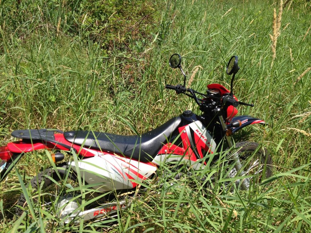

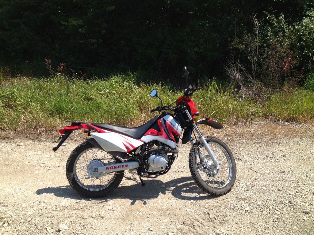

On a side note, I went and got the plates for it today. Here are a couple of pictures from on my way home.

Nice pics. Your bike thinks it's a crouching tiger in the savanna!

Thanks for posting the photos of your bike in it's native habitat! I really like the looks of your Roketa DB-05.
