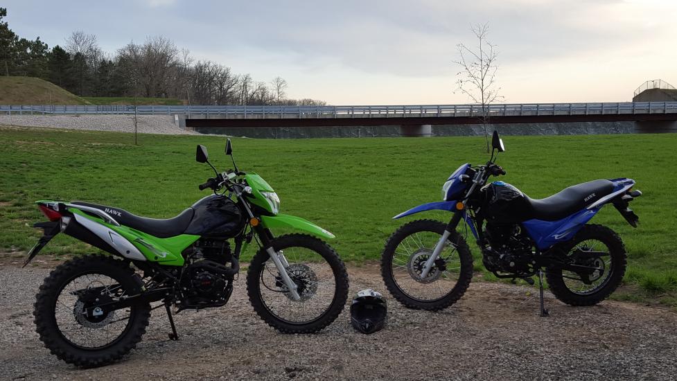

good times
Old 03-26-2016, 09:22 PM   #3
Bruce's   Bruce's is offline
Join Date: Apr 2015
Location: Sudbury ,Ontario
Posts: 855
Is it me or are those bikes really low in the front ?Did you slide the forks down the triples when you assembled them ,or is that how you received them ?

you can see they have to slide them down yet. sticking above the top tree about 3-4ln.

well guys you would be right that i haven't adjusted the trees at all would anyone have a recommendation on where they should be at. (might explain why we keep hitting the wheels on the fenders on bumps)

all the way to the cap

thanks ron b this is my first time messing with a brand new bike so i wasn't aware they needed adjusted. also is there some way to keep them from slipping in the future those friction retainers just look like they are gonna let them slide eventually

All the way to the top is the general baseline ,but depending on your riding style and use you might like to drop it a little .

The bolts of the triple tree will hold the forks very well. You only need to torque them about 10-15 foot pounds.

thanks for the toque specs info spud gonna fix both bikes tomorrow
