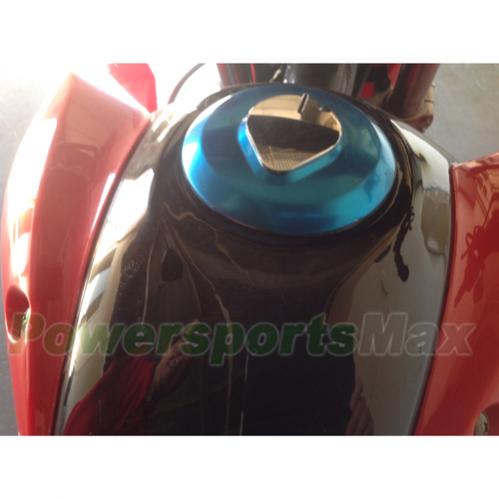

So this is a stock photo from the website I bought the Hawk from. I am certain it's the keyhole flap. Horrible buzzing, if I even lightly put my finger on it, it stops. So, I'm either going to have to find something to "jam" in there to keep the buzzing down, or try getting the flap off.

Most of this style =
As found on "ancestor" JH125L http://forum.jorsindo.com/forum.php?...rtype=1&page=1 (based from 80s XL125S)
Honda Twin: CB125T, CM125... Thumper: MCR125 , CGR125 & tons copycat...
"Buzz" is a common topic discussed in "MCR" board http://www.chyangwa.net/thread-604136-1-1.html | http://www.chyangwa.net/thread-90120-1-1.html
Typical syndrome appears when 4.2-5K rpm / tank isn't full...
Solution: Use something such as http://hengdatech.gmc.globalmarket.c...e-1374748.html glued that "fuel proof material" stop the buzz

or tape some duct tape over the underside, that ll stop the rattle, make sure u don t cover the venthole if that s how this tank is vented

Sometimes front cushion (Honda: 17611-286-000) cracked & "magnifies" those annoying buzz...
Quick & free solution: Replace it w/ a chunk of rubber thingy (non-function inner tube, old fuel line...) stops the headache....

Thanks everyone for the ideas, HB is the winner of the diagnosis. Since I got the Hawk I have been chasing down the little squeaks and buzzes, I realized today that the gas cap buzzing was a fairly new issue and the last one I had. Last night I tried wedging a couple super thin vinyl disc( think the little disc on a glass coffee table between glass and frame) it actually made the sound worse. I realized the "flap" has a lot of free play, on purpose, for snags and what not. While the buzzing is coming from the flap, it's the overall vibration of the cap that is the issue. I stopped to get gas on the way home, no buzz on the rest of the ride home. So as HB posted from other forums folks having issues when their tanks were not full, also appears to be my issue as well. I'm going to give a little thin foam weatherstripping a try under the cap area around the mouth, and hopefully that will do the trick. Thanks again all!
