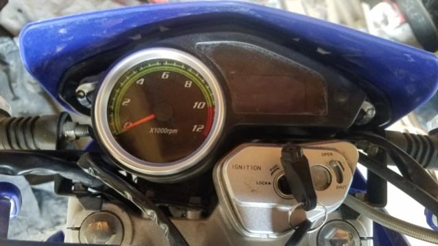

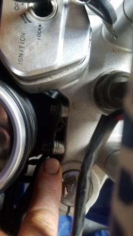

OK, After watching popeicus86 & motocheez's videos, I see the clusters are SLIGHTLY tilted. Mine was too and i thought it was my bracket but it looks as if it might be in the mold used to make the cluster. What i did is loosen the mounting bolts and stick 2 lock washers under the Port side of the bracket shown in this photo. The cluster is now level.....
Mjstef, I did that to my hawk's original cluster for that same reason.That was the first thing I noticed when I sat on the bike how off it looked.I'm in the process of installing the sharp looking new cluster you sent to me.Thanks
