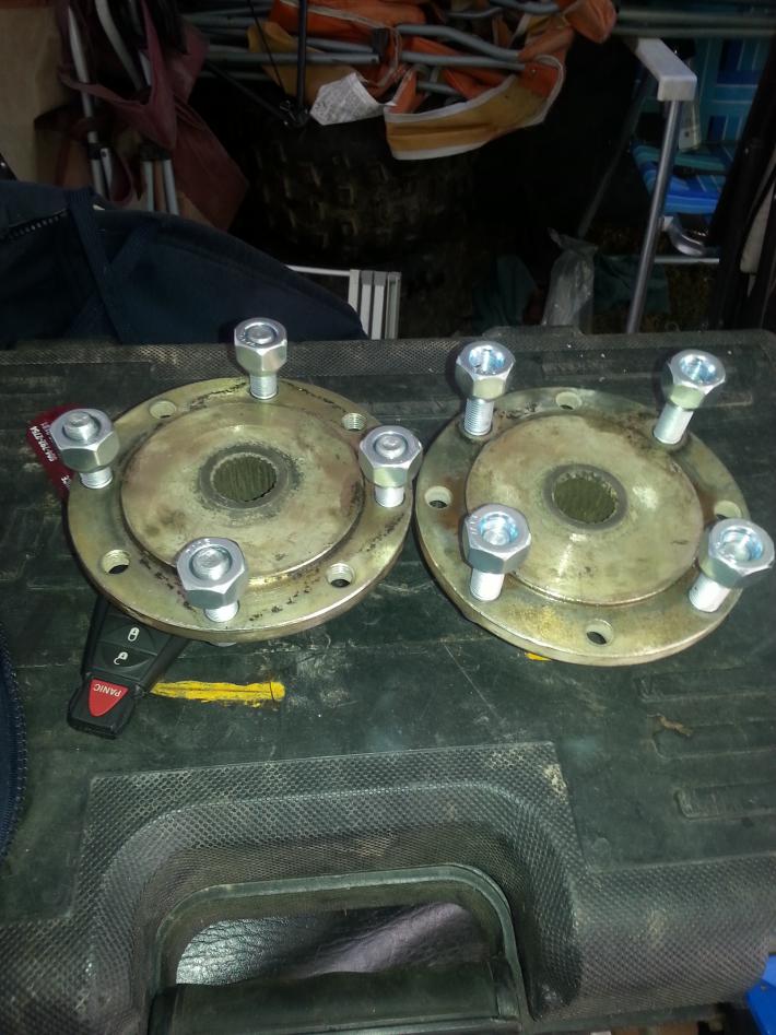

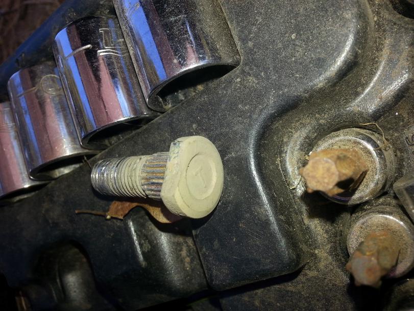

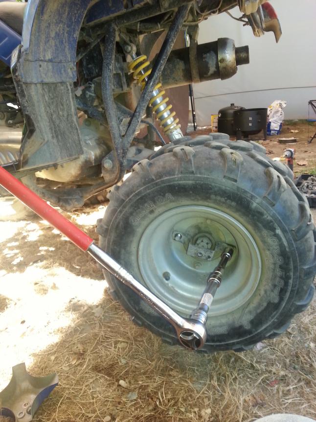

so as I am going to remove the old tires every stud strips as I am taking them off......left side didn't even have a nut on one of the studs and the cotter pin was missing.
could not find any studs on the interwebs ....only thing I found was the same hubs and they didn't come with studs.
had to do a bit of sluthing and came up with the next size up from local auto store and with the help of W&G and his shop tools managed to drill out the holes and press in the new ones.

this is an odd machine....it has huge sprockets and a 520 chain like a dirt bike 0_O
the hubs appear to be off a 200cc (from what I have seen) and are bigger and a lot heavier than the ones on my 250cc.
anyone else ever seen this in a CB?
