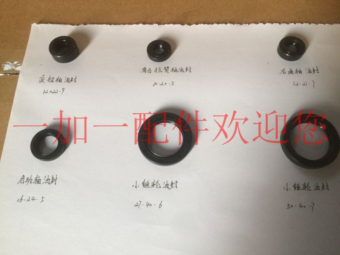

There's # stamped on it in theory. https://item.taobao.com/item.htm?id=533102531689 lists those...
Decent local shop (bearing / hydraulic ...) had those thingy...

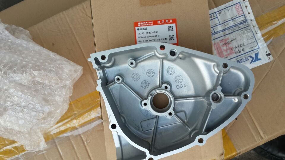

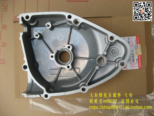

Stator cover: 11351-05302 (as GN125/ Gs125) / Recent yrs DR200 may also fits cuz the gasket shares the SAME#...
Generic: http://item.taobao.com/item.htm?id=35217645233 | Genuine Qingqi: http://item.taobao.com/item.htm?id=3161268466
REAL Suzi is tidy... Isn't it?
Qingqi Suzuki
Dachangjiang (Suzuki's favouriest chinese parther that makes Newer model such as Gw250...)
Gasket: 11483-05312 https://www.bike-parts-suz.com/micro...image=Chercher
