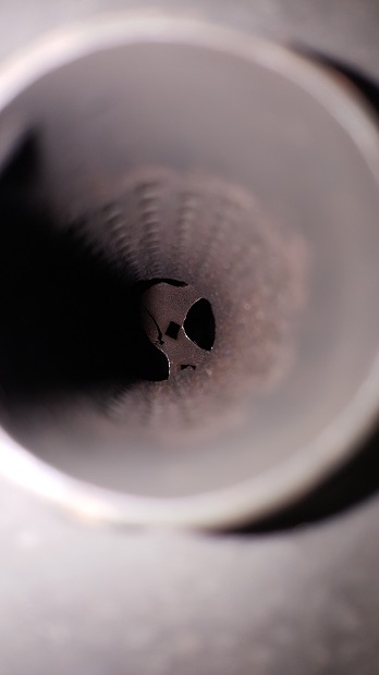

If you plan on removing the catalytic converter also drill a few holes in the baffle. I drilled four 3/4" holes in mine to help it flow better. I plan on putting a larger diameter tail piece and spark arrestor.
