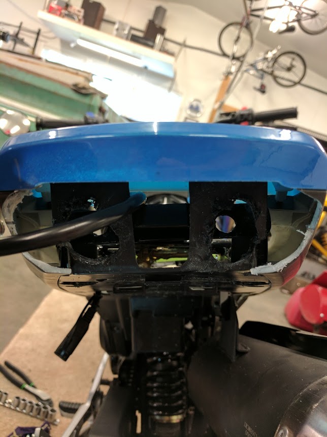

Another problem I've had with vibrations on the Vader. The break light. Since I've installed the fender eliminator kit it's just been floating and vibrating like crazy.
I'm looking for suggestions as to how I could fix that..

so i fixed quite a bit vibration from my brake light after i installed the grom integrated tail light and made a custom bracket and it has really made the back in more solid i attached the 3 pics of what mine looks like.

That looks nice! I've been thinking about getting an integrated break light, not sure which one I want yet. I'll start shopping around, doesn't look like too much work. Thanks for the idea!
