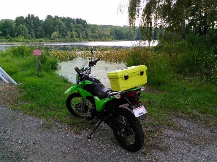

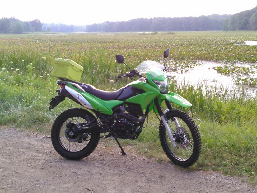

I finally got the 27.5 pilot jet install with the 110 main jet, 1 1\4 turns on the mixture screw.
It runs much smoother no more shutter at low throttle and the
exhaust pop is gone.
The idle seems to float around a bit now though so I need to do
some slight adjustments.
After that I took it on a 25 mile ride out in the country and around
Mogadore lake it definitely runs smoother and my cruising speed is around
50 MPH where before it was around 45 at the same throttle.
How about some pictures!
