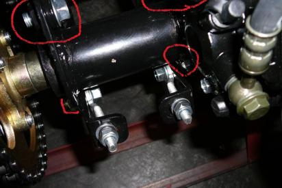

HELLO.... here is what I tell all my customers to do..... after they take the extra nut from the right side adjuster... as it is for a adjustment they will not do... once it is removed... then do the following.... the main thing is not to have the axle correct compared to the front steering axle... if the right side is farther THEN you can use a comeable strap..( tarp strap tie down strap ) whatever you call it.. to sinch the right side up to even the sides.... only once the axle bolts are loose... then follow the instruction... about 1/2 inch free play on the chain... allows for weight... can not load pic ... too big.. but that is the key thing.... MAKE both sides the same spread... then the rear axle runs straight.. and the gears are inline with each other

ok, I got the pic... a lot of you guys know how to adjust the axle so this is for a lot of the new people..... the main thing I see a lot of pushing their atv up against a wall or other things... this is simple... if one axle has to go forward... AFTER YOU HAVE ALL THE BOLTS LOOSE... just use the ratchet strap around the rear axle and up to the front right A ARM... then ratchet forward to move the rear axle until the measurement is within 1/2 spread.... this is the LAZYMAN WAY... works for me...

wow that's awesome,
truly appreciate the picture..what's interesting overall is how basic the units are, as they require wratchet straps and the like for adjustments, but it is what it is..
