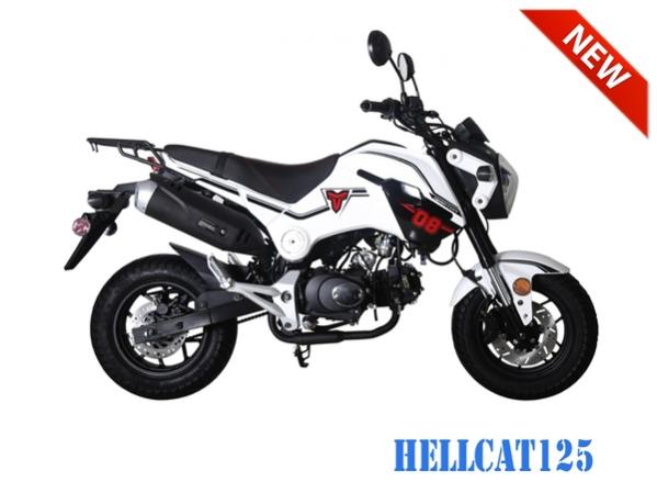

Taotao now has a glv (Grom-like vehicle); I know it is nothing special since several minis are already on sale, but I think I would put this one above all but the SSR Razkull on my shopping list because Taotao have vastly improved their quality the past couple years.
http://taotao.us/index.cfm/electric-...es/hellcat125/
