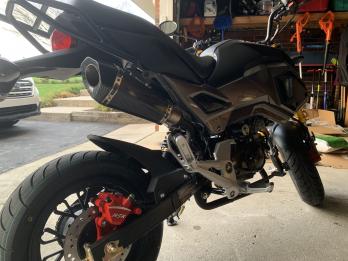

Grin
Finally got mostly everything figured out, venom is shipping me a new speedo plus every fairing on the front end. The clutch is working perfect, the only problem I’m having now is gas leaking from somewhere. It’s not a lot and only happens after I ride. Almost forgot.. the axles were WAY under tight and was causing vibrations and noises.
