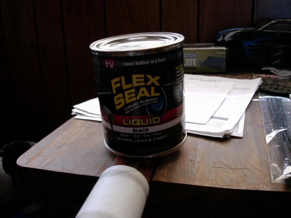

I'm going to try and fix the hose with some Flex seal.Put 3 or 4 coats on there and let it dry good between coats.

yaa, i get it with the Flex seal, but i'm still a fan of one and done being the cone filter and calling it a day, trust me, your going to have a ton more things pop up to repair.

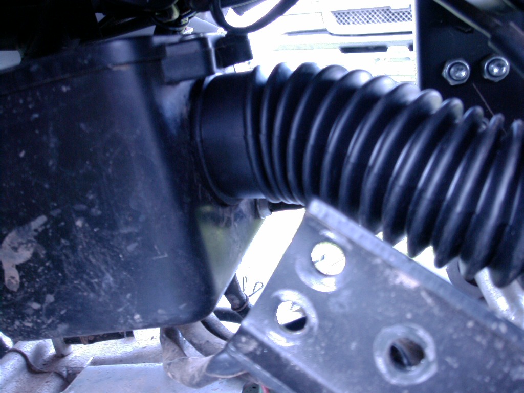

I'm back to the split air hose coming from the air filter box to the carburetor,this time it has split right where it goes into the air filter box.Have gone ahead and ordered one from VMC and it should be here today.

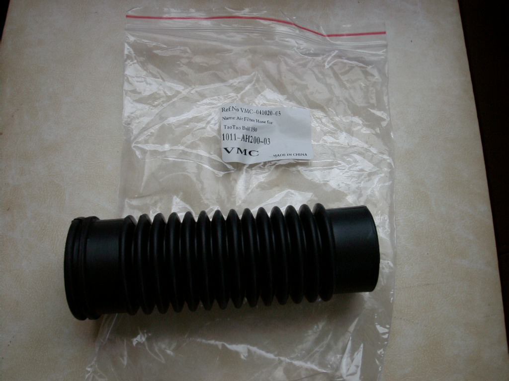

Got my new air filter hose put on today,took me about 2 hours to get the old one off and the new one from VMC on.I had to take the right side motor brace loose so I could get to the hose clamp on the carburetor.Then I had to take the front air box bolt out and then loosen the rear air box bolt to let it move around enough to get the back lip of the hose inside the air box.The new air hose is more of a plastic,little stiff but I bet it will last.I had pictures but can't find them now.
