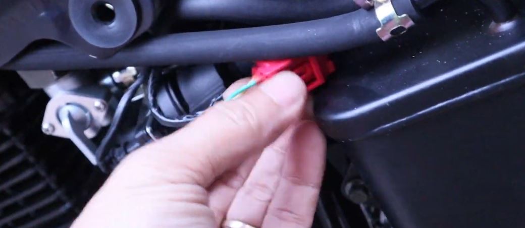

There should also be a 4-wire diagnostic hiding somewhere on the bike, either back right like the KPR, or possibly left side just astern of the petcock assembly.

There are four common ODBII protocols. If your multimeter can read PWM/RMS signals (fluke 115 or better) you can measure out the voltage levels compared to ground and figure out the data transmission type per this page:
www.onboarddiagnostics.com/page03.htm
Mix of 5V and 0V - J1850PWM
Mix of 7V and 0V - J1850 VPW
Mix of 12V and 0V (on the signals) - KWP2000/ ISO9141-2
Mix of 3.5V and 1.5V - CAN
Then you can put a Bluetooth OBD2 on a 4-pin adapter wired appropriately and watch realtime diagnostics as you ride from Torque or other app of choice.
Of course, any findings should be directly applicable to your KPM as well.

I found the test plug on the X-Pect no problem, it hangs out above the fuel pump. I'm going to order a Bluetooth OBDII reader off of Amazon now. This will be interesting to see what's happening in real time.
