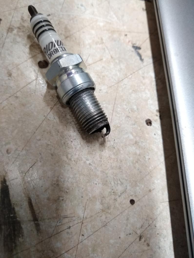

Keep checking your spark plug. The electrode insulator should be tan in color when the jetting is right.

Did you check the spark plug? I bet it is crayon white.

here's the plug

I put in another plug and it ran much better, but this plug was brand new. I bought it last month when I bought the bike.
The stumble is still there.
