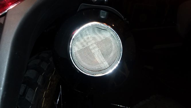

I used this for the stock muffler on my BSR Raven, it fit between the baffle and the tail-cone:
https://www.amazon.com/dp/B081174N8J...roduct_details
This one would have probably worked better, wouldn't have had to bend the tip over:
https://www.amazon.com/dp/B01FVCWOFU...roduct_details

stewbrash, the arrestor you used https://www.amazon.com/dp/B081174N8J...roduct_details is pretty close for the DLX. It seems to be almost big enough around; I'd have to re-drill for three holes instead of 4. At $14, it's certainly cheap enough to try, and I wouldn't have to add any extra holes to my exhaust.

I assembled the tail-cone over the wire spark arrestor and the pressure from screwing in the bolts that hold the tail-cone on compressed the arrestor around the exhaust-pipe coming out of the muffler...kind of hard to explain. No new holes or drilling.
