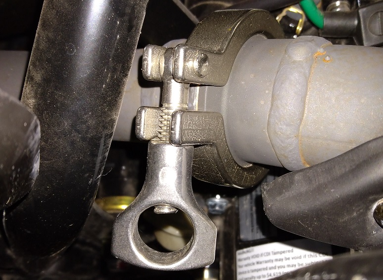

What is this exhaust bracket called?
One of the boys forgot to tighten his bracket down as I told him too, and it ended up falling off. But I cannot figure out what in the world the thing is called in order for a new one to be ordered.
It is the bracket that holds (what I call) the exhaust header and the exhaust.

It's a sanitary clamp. I don't remember the exact size but can be found on Amazon.

Wow. That almost doesn't seem right, nomenclature wise.
Thanks!

I saw post few years ago JerryHawk250 said he safety wired his and I promptly did the same. No problems since.

That is a funky name of a part to see on a motorcycle . I thought it was a v-band clamp at first glance.

I don't remember the exact size. You will have to take some measurements. Here's a link. https://www.amazon.com/QiiMii-Stainl...2s9dHJ1ZQ&th=1

I was curious so I looked up what they are designed for;
Sanitary clamps and hangers are for use with stainless steel piping systems in a food, beverage, and biopharmaceutical applications.

not a muffler clamp for sure

I don't remember the exact size. You will have to take some measurements. Here's a link...
Thanks Jerry Hawk! That is the exact one we purchased. It was good for him to actually use his mathematics to go from the circumference of the pipe to the diameter. Finally something that he cares about uses the math that he was required to learn.
We received it rather quickly and it did the job perfectly. No more exhaust rattle or exhaust gas bypass to heat up his leg.

Put a safety wire on it and it will never come off again. Mine kept vibrating loose but was lucky it never feel of. After putting the safety wire it never got loose again.

Those things do have a tendency to fall off. I lost mine sometime in the first 100 miles, but I knew about where it fell off. I searched about 10 minutes before I found it.
