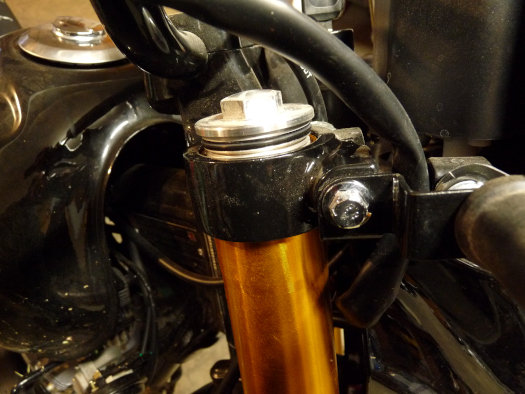

My Storm has a manufacture date of Oct 2020. I haven't looked into the fork oil yet, but the USD forks have full travel, bottoming out without too much of an impact. The lower end has a recessed ~6mm allen bolt just like the ones on the non-inverted forks I've worked on, but no drain port. I always used a mallet-style impact wrench to loosen that since the internals rotate freely when loose. I imagine this will be no different?
I just loosened the cap on the top end to open it up, but it keeps getting pulled inwards (!!) at end of thread travel, as if there is a vacuum inside the tube!
Does anyone have pics of this fork tube disassembly process?
Maybe the spring is holding it by friction (pushed into the cap), and you have to dislodge it??? But that doesn't make sense-too much force on the aluminum cap upon impacts, I'd guess. The spring can't be right up against that aluminum cap!
