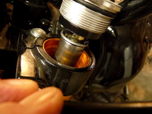

I just pushed the fork down, and it got pushed out (compressing the companion fork tube):
Someone posted on this forum an add-on valve modifier to standard shock damper for adding a simulation of the mild slow damping and stiffer fast damping that the more sophisticated Showa dual reservoir USD shocks are capable of. Having USD forks with standard damping rods is better since they are much stiffer than conventional forks, but damping rods can't address the extreme differences of a light impact and a severe impact.
It is the Racetech cartridge emulator that adds this capability(and maybe there are other similar options). This seems like the only way to really improve cheap USD fake cartridge USD shocks like the one on my Storm. I need to inspect the Storm USD inner diameter and maybe contact Racetech. They have many different models for different shocks. Here is the information on how it works:
https://racetech.com/page/title/Emul...%20They%20Work
I don't think that volume of fork oil is the right approach. Obviously, it is important to use the right volume to get the best performance from the standard damping rod style shock, but it doesn't fix the slow dive problem! It really seems worth it to add the cartridge emulators if possible. They separate light damping (a pilot circuit) from main impact damping which has essentially infinite valve preload adjustment.
