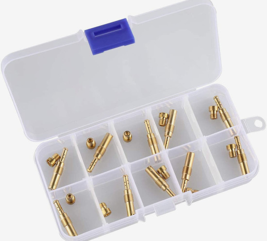

I did not cut the heads off the screws. I cut a flathead slot into them with a Dremel and reused them. I got Allen bolt replacements but they were the wrong size !!!
The jets were from one of two sources. The pilot jets were from a kit I got from Amazon, and the mains were from AliExpress or Alibaba. I will find the Amazon link. Alibaba links always change. Maybe I can find it.
UPDATE. The main jets in the kit from Amazon also fit...The jet kit is described as this at amazon:
Supermotorparts 10Pcs Carburetor Main Jets kit & 10Pcs Slow Pilot Jets for PWK Keihin OKO CVK PWM
$12
