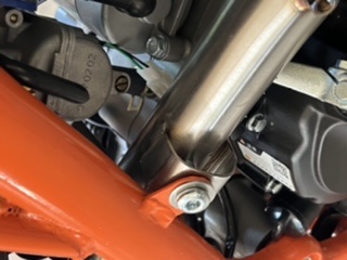

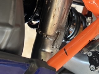

Some low res pics of my shade tree stainless welding. Had to cut the straight section behind the frame mount and make a new frame mount. Unfortunately, my joint had too big of a gap and I hit a burn through. Made a sloppy-poppy patch and while not pretty, it works. I ain’t going to be welding in maranello…
The RBX pipe was too long for my base model and the muffler is a bit wide. Still fighting a bit of tire rub. It does work for the engine temps and it’s not louder than the stocker, as the stock unit was loud. Best part is I can throw her back to stock in 10 minutes.
First creek crossing and I rode home 15 miles oblivious to the vines wrapping the hub, guess I ain’t gonna be riding in Maranello either.
Wish I went with the 40 or a 39 rear sprocket, the 42 is better but I wouldn’t mind a bit lower.
