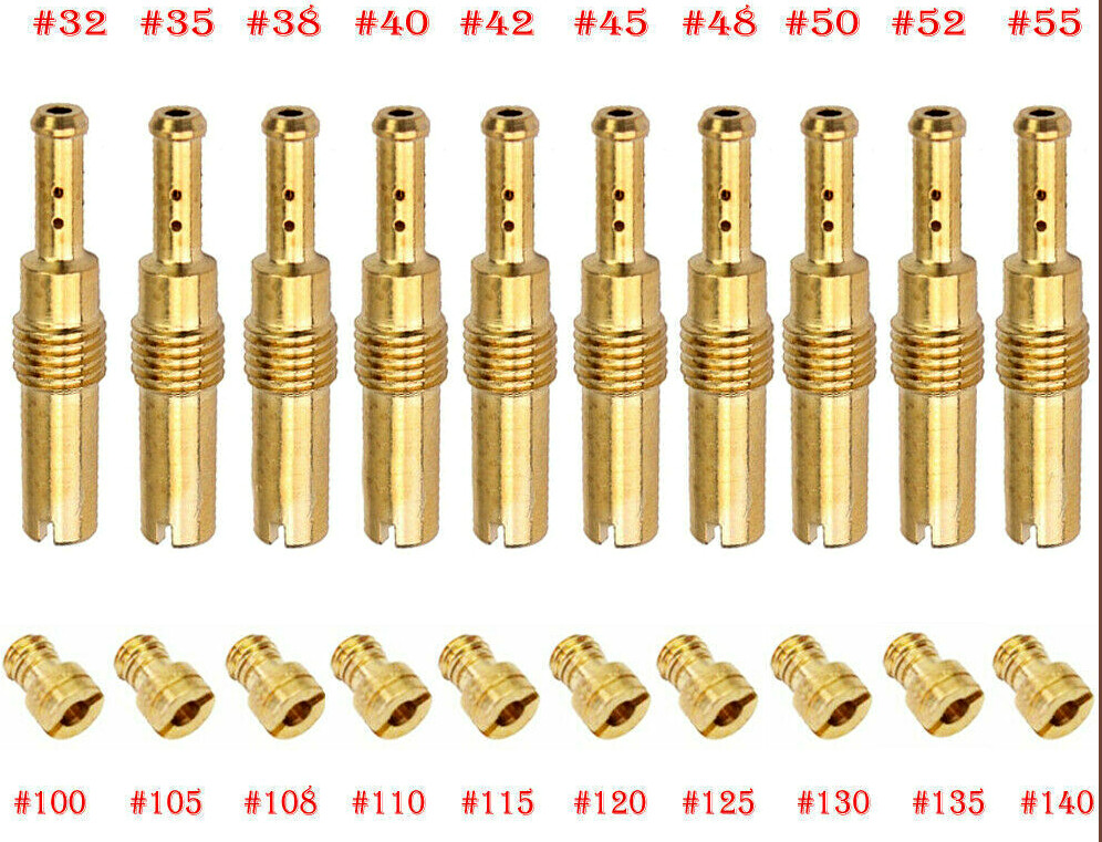

I just got a pack of these jets. Perfect and less than $8 on ebay
*item 334527584998, Description:
"Carburetor Main Jet 10pcs/Set Slow/Pilot Jet Kit For PZ30"
Vendor is shmoto. They arrived in TWO days.
Original 120 main, 40 pilot
installed 125 main, 42 pilot (or 45 in hot weather, low elevation)
installed 125 main, 42 pilot (45 was too rich, didn't need choke in cold weather!)
