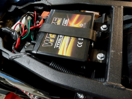

I thought I had melted my ground wire so I replaced my wiring harness. It turns out it was a faulty starter (which I fixed), but while I was at it, I got a new set of led sequential turn signals. I just tried the in the back. Maybe I will save the other two for now. Just under $20 from amazon. Sweet!
I also replaced the battery with an 80 CCA bigger battery. It barely fit, but much more power!
Attachment 27696
Cool man missouri huh same here is that a chopper or sprtster? I'm in missouri too let's start a club lol!!

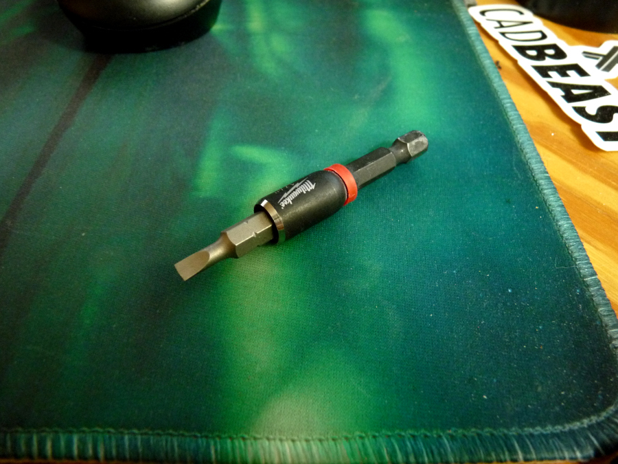

I drilled out the pilot air mixture screw adjustment blockoff and reset to about 2 turns out. I had previously rejet to 42 on the pilot jet, so took others advice and thought 2 turns would be OK.
It was WAY too lean on mine. I closed the air mix to just under 1 turn and it starts/idles great now.
On the Keihin clone Youall smoothbore, this is an airscrew. Opening it adds more air to the mix. So closing it to 1 turn enriched the mixture.
The main clue was popping and backfiring. These are signs of lean mixture. I was thinking CDI or something!
It is HARD to get a screwdriver onto this. On mine it is right behind a frame stay. So I used this 4mm screwdriver bit on a short magnetized extension. This REALLY made adjustment easy:
