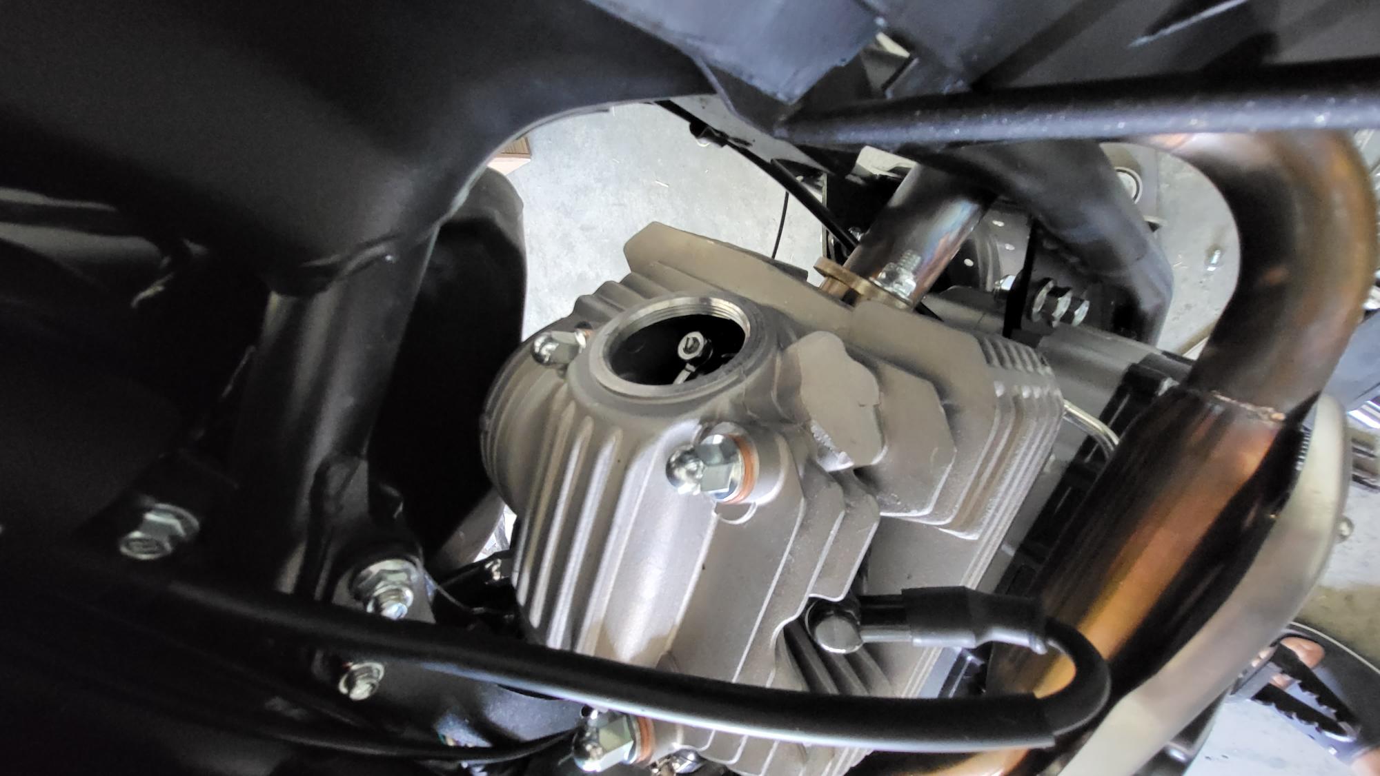

Initial maintenance performed before start-up: popped the tank off (2 bolts), removed the valve caps, spun the crank to TDC and set the valves to .04mm (tightened on a .05 adjuster blade which lets .04mm blade thru) I read that others have set tighter than this but i figure this is what i've set the Brozz and Titan to and they perform great plus the valves can only tighten up with time.

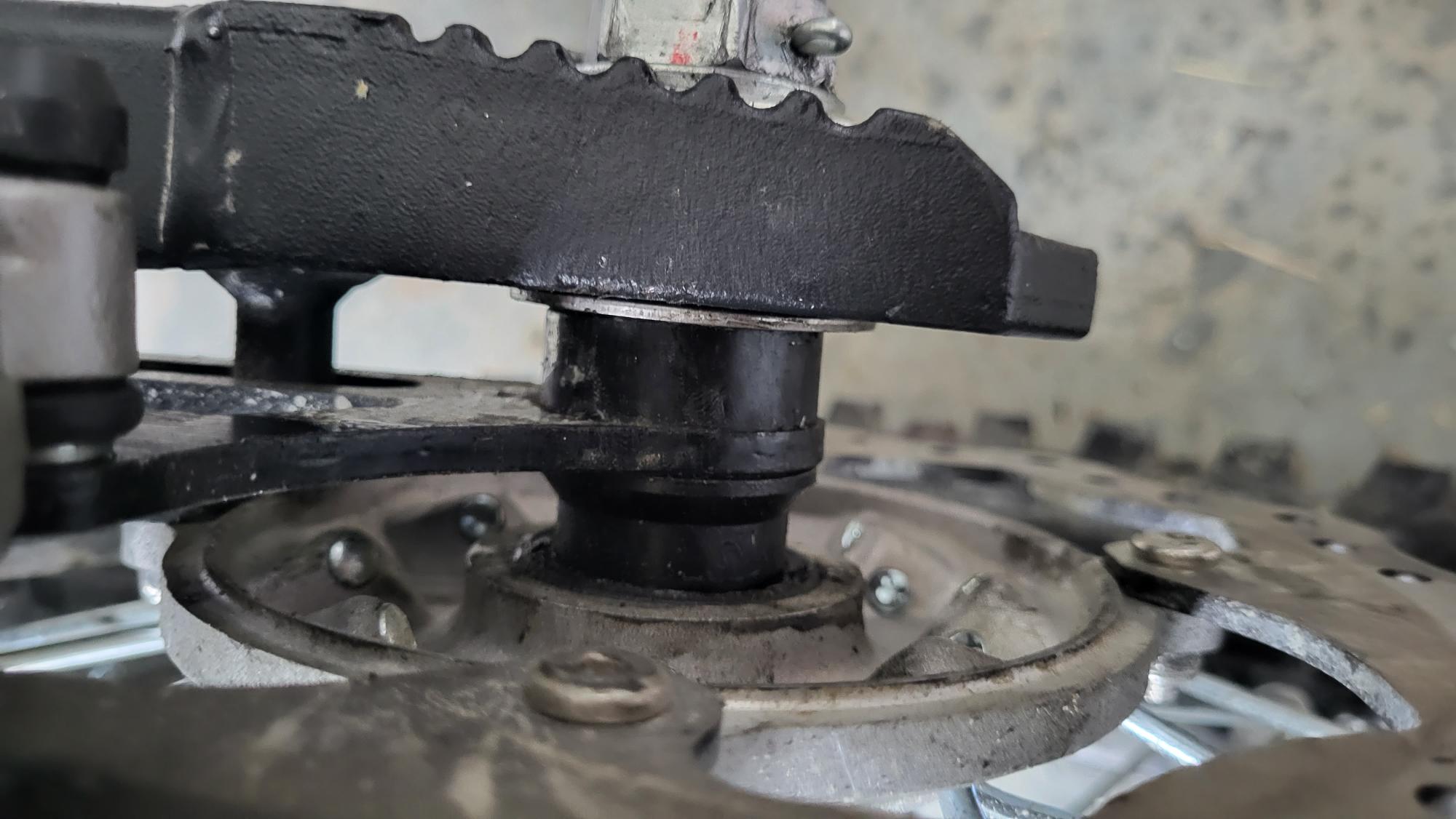

PSA: when the rear axle is tightened there is a drag on the rear brake that makes the rear wheel hard to spin. The remedy (thanks dslfrk) is to add a large washer on the inside left of the swingarm. see attached pic. this allows you to torque the nut to the proper spec and/or add a cotter pin for extra safety
