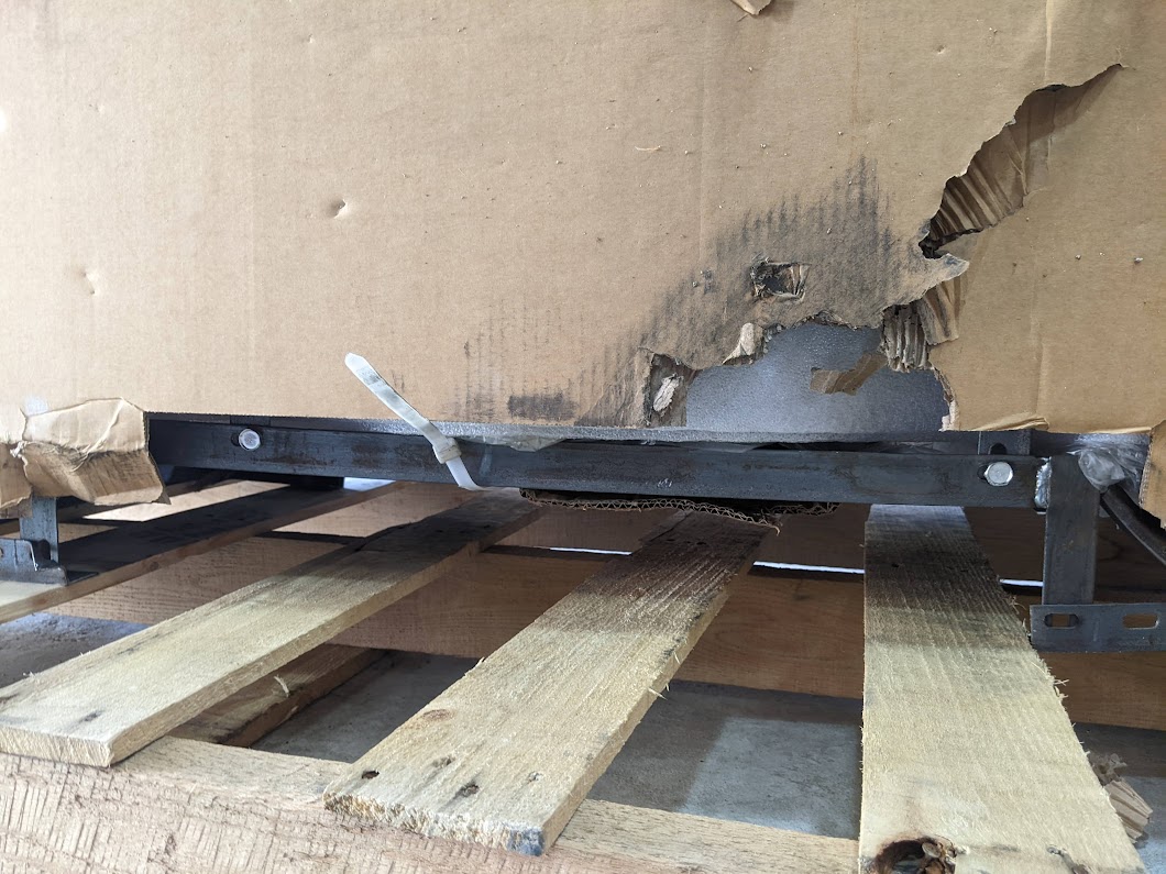

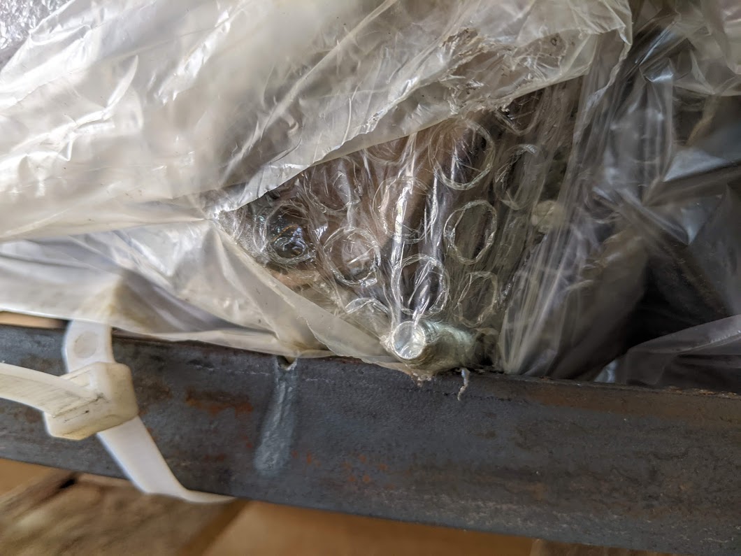

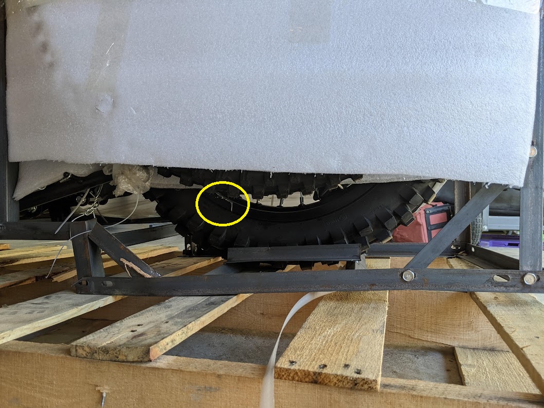

I now believe that what I actually received may have been somebody else's rejected delivery. It arrived in a beaten up cardboard box and bottom of crate bent up. It was NOT shrink wrapped, much of the internal packaging was intact but very beat up. It had no protective film on any of the decals.
Damage in no particular order:
Both sides of the outer cardboard and inner shipping cage had damage.

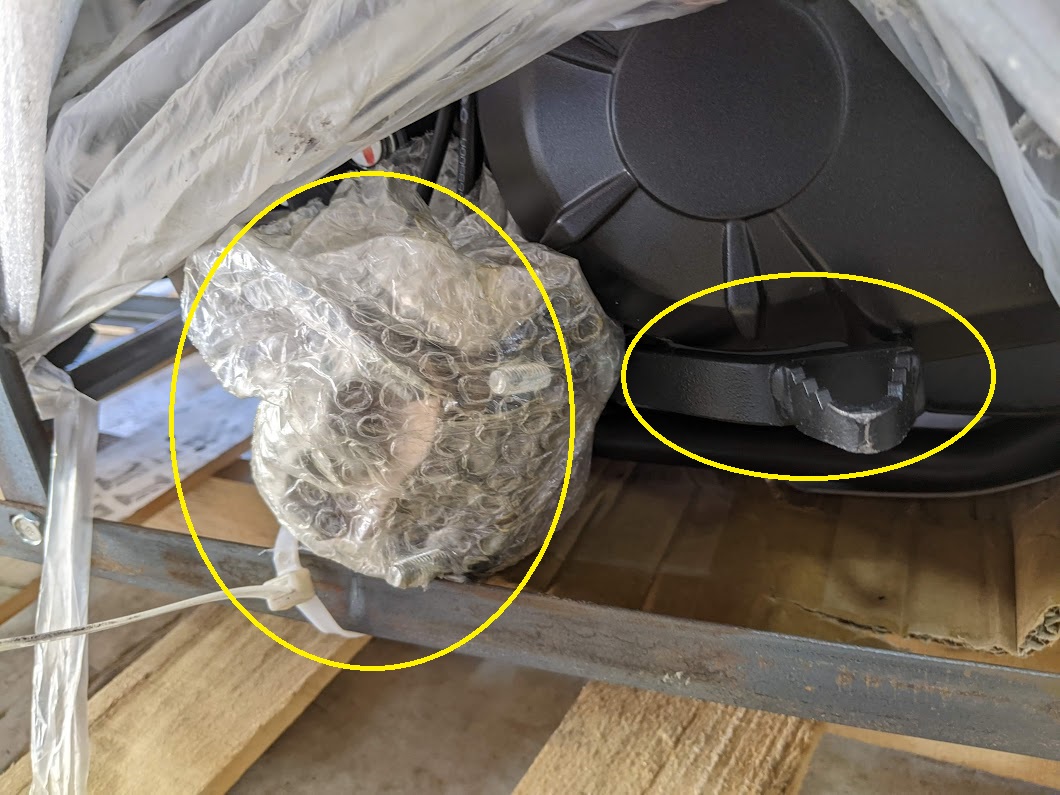

Where the handle bar and front caliper was packed was bashed in. The front brake lever was bent, and master cylinder gouged. Starter button switch sticks engaged. The front caliper was scuffed and the rear brake foot lever was bent into the engine case.

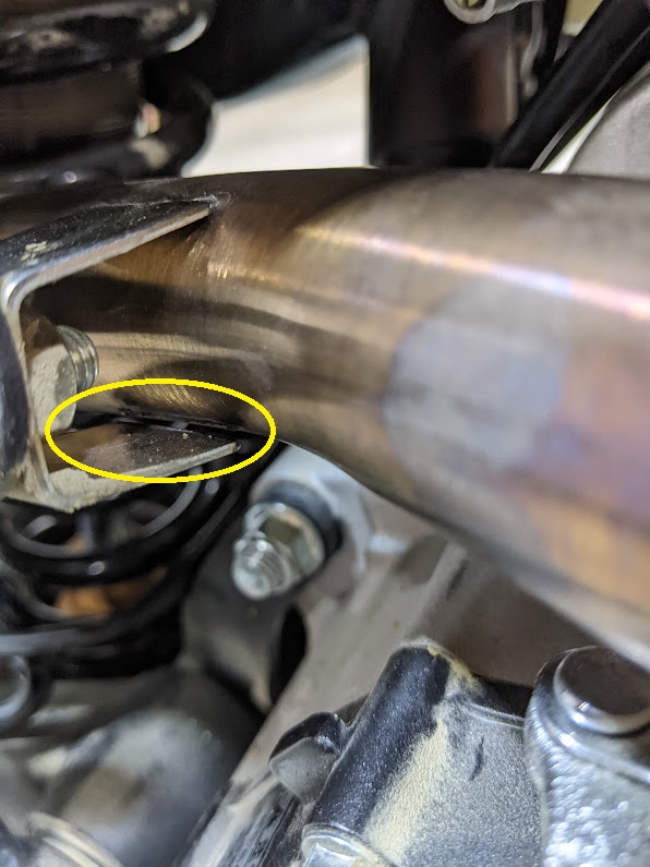

The exhaust header pipe bracket has a broken weld.

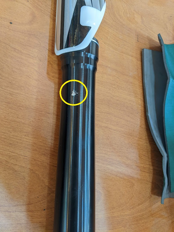

The forks had not been fastened securely enough and both fork tubes have dings and gouges in them. Missing front axle pinch bolts.
On the other side of the bike/cage, the front wheel had been pushed/shifted into the rear turn signal stalk causing it to split.

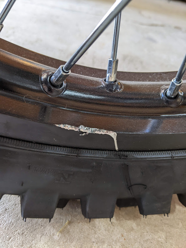

The rear wheel rim had a significant gouge along the rim edge and into the tire. The handlebar pad cover is missing velcro and can't be attached.

I do not want to appear critical but are you claiming a new packaging crate cause that is all I can see barring a scratch on the back rim. What other damage was there to the bike itself. The difficulty here is where was the damage done at Powersports Max or by the transport carrier. Once the package leaves the supplier the carrier would be liable for damage and if you can prove that they caused the damage you would have to deal with the carriers insurance and good luck with that. But still you should expect Power Sport Max to assist you in sorting this out.
I get it, pics or it didn’t happen, but what part of “ Will try to add some more photos later.” did you miss? Again, if I would have been home I would have rejected delivery and would probably be still waiting on a replacement. I am hopeful x-prousa/ powersportsmax/ maxpro/ motopro will make it right. All reports indicate they will and I am patiently waiting and will attempt to contact them again. Just wanted to share my experience good/bad/ugly.

90% Complete after assembly oil change and first test ride down driveway. Had not attached tank plastics yet. I guess I didn't get any shots that clearly show just how bent the front brake lever was, arrow shows direction of bend.
I went ahead and bent the rear brake pedal out from the case and the front brake lever so it wasn't so hard to reach.

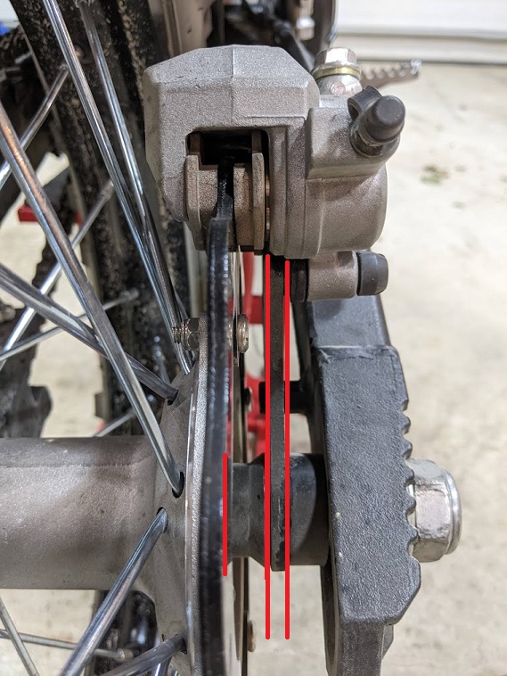

Like others (dslfrk, tnkj99), my Templar has the inside pad on the rear caliper drag (significantly) on the rotor such that you could hear it drag/moan when just leaning on the seat or moving off the kickstand. The caliper is located over the rotor based on the dimension of the inner spacer and/or any bend/offset in the caliper bracket/arm. A few thousandths taken off the axle spacer and the barest tweak of the caliper bracket has solved my drag... I would also be interested in the mfg tolerances of the bracket. A washer on the swingarm side of the caliper bracket has helped with aligning the swingarm parallel after this photo was taken.
