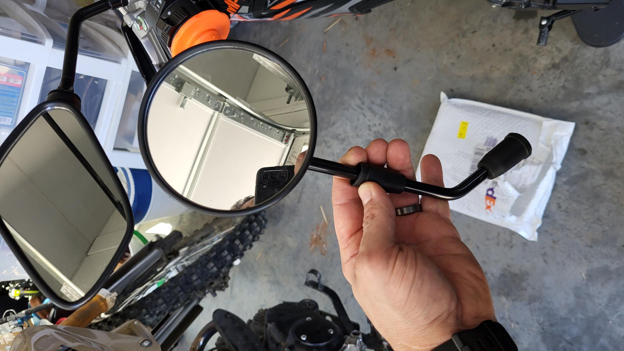

Also, PSM mailed me replacement mirrors but ugh! they are wrong ones and look like something you find on a scooter! I emailed them to that effect and they are pushing back that the stock mirrors are out of stock and these round ones will work with my response being imagine having a Toyota that you needed replacement side mirrors and the dealer sent you something off a Chevy, cmon guys! I'm hoping they make it right,
will update accordingly

Update: PSM will be refunding me $15 for the mirrors which should cover the cost of a similar replacement set i found on Amazon.. good on them to again make it right after a few email exchanges

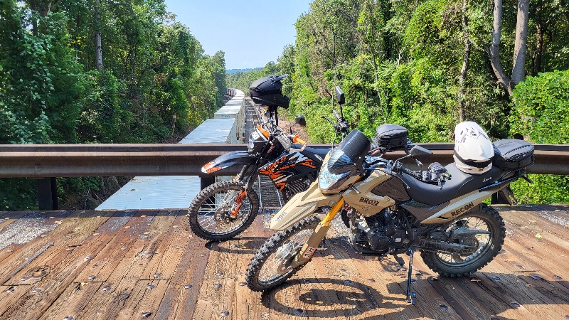

Saturday ride with my son
