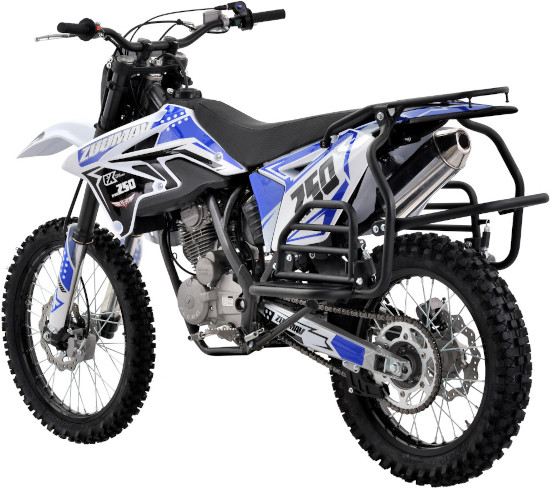

I just do a Google search for what I'm after and append "chinariders.net" to the search like
like ...what about the panniers? Please advise.
FYI, that luggage rack is on a Templar motorcycle like ours (X model) that is sold on Alibaba. The luggage rack itself is currently NOT available separately on Alibaba.
We have asked PSM whether they would offer the racks, and they responded positively, maybe two months ago, but the rack has not showed up on their website.
If you want to buy that rack, join the few people that have contacted PSM and asked for a part number, and offered to buy the rack if it becomes available. Only persistent requests might get PSM to order some of them from Zumaav. But they are unlikely to order any if there is insufficient interest.
