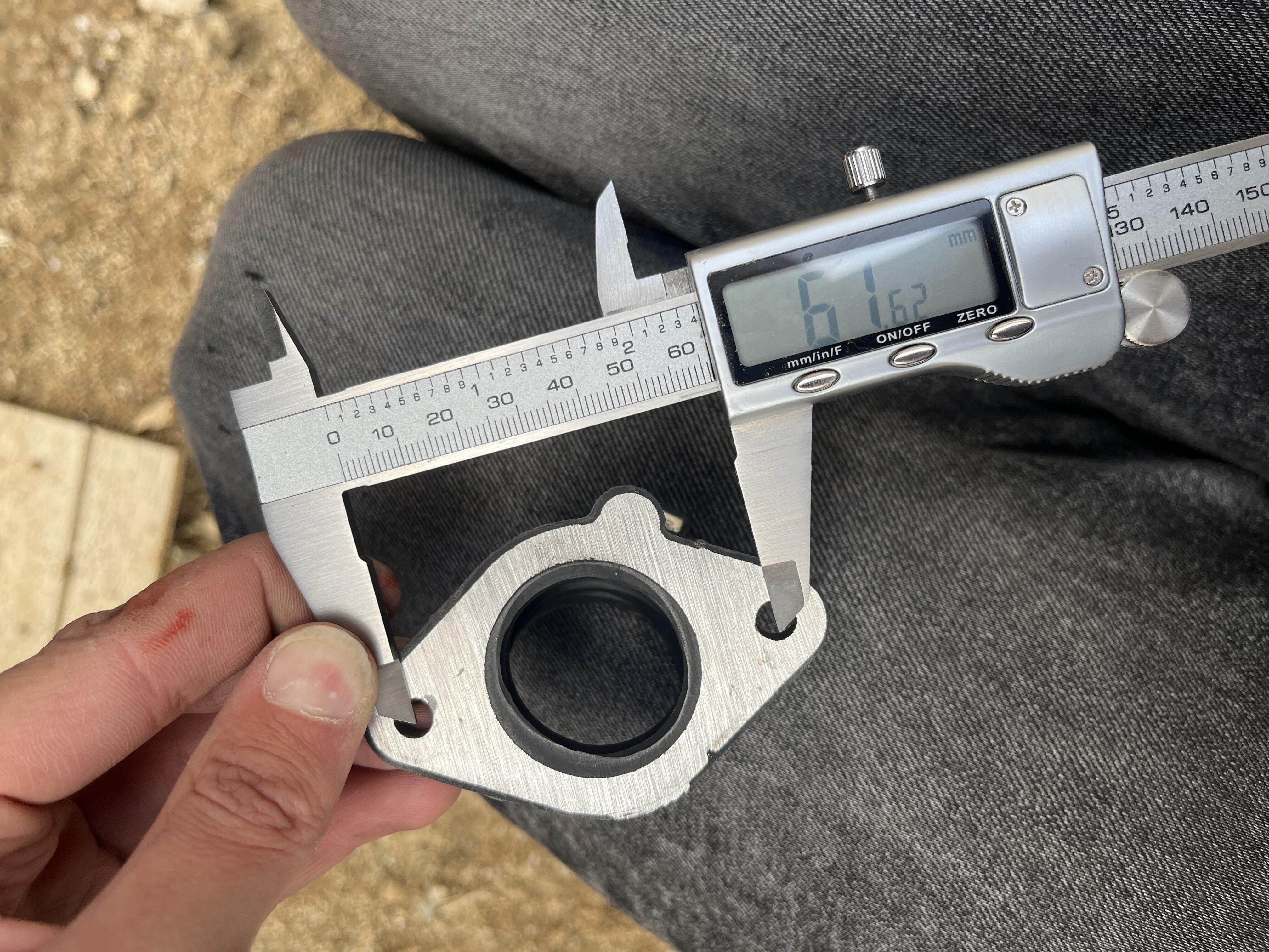

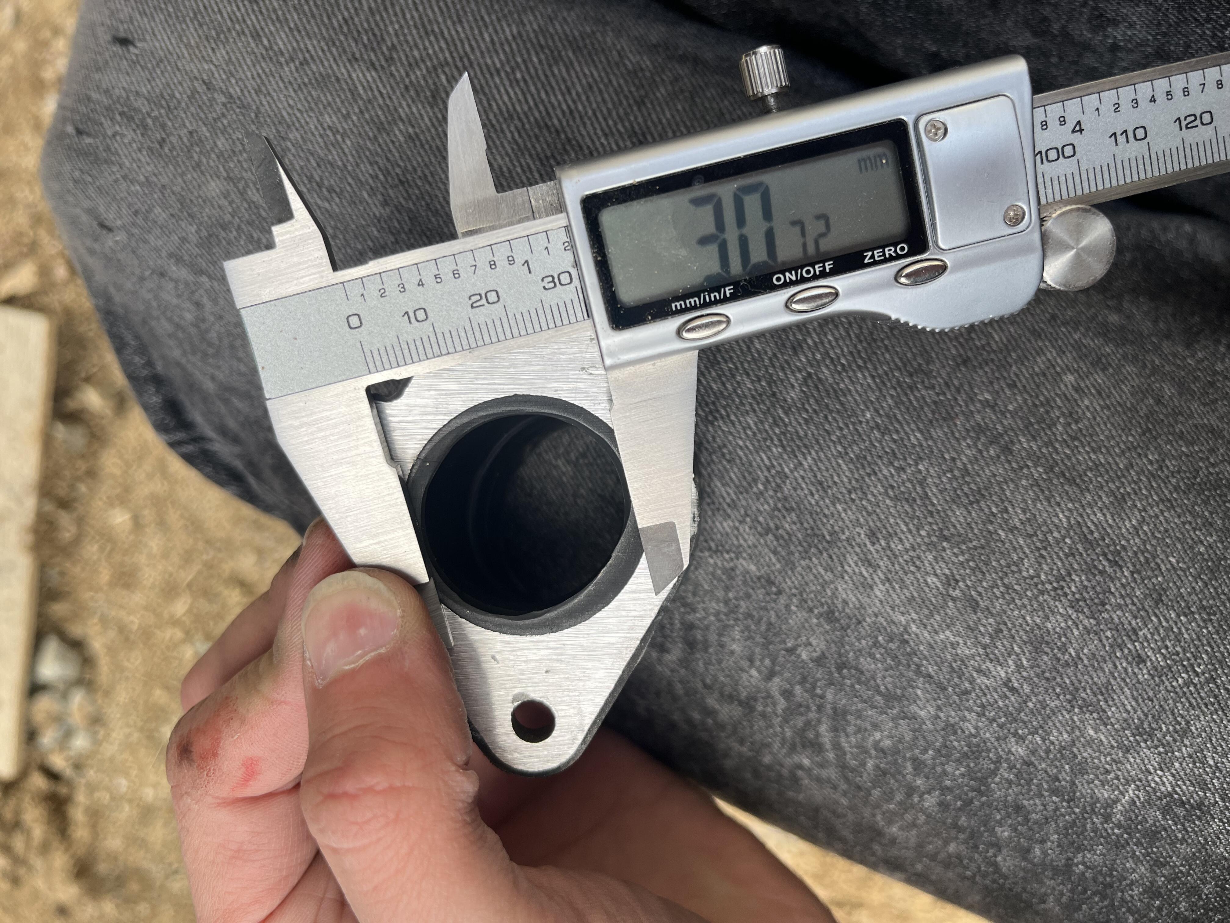

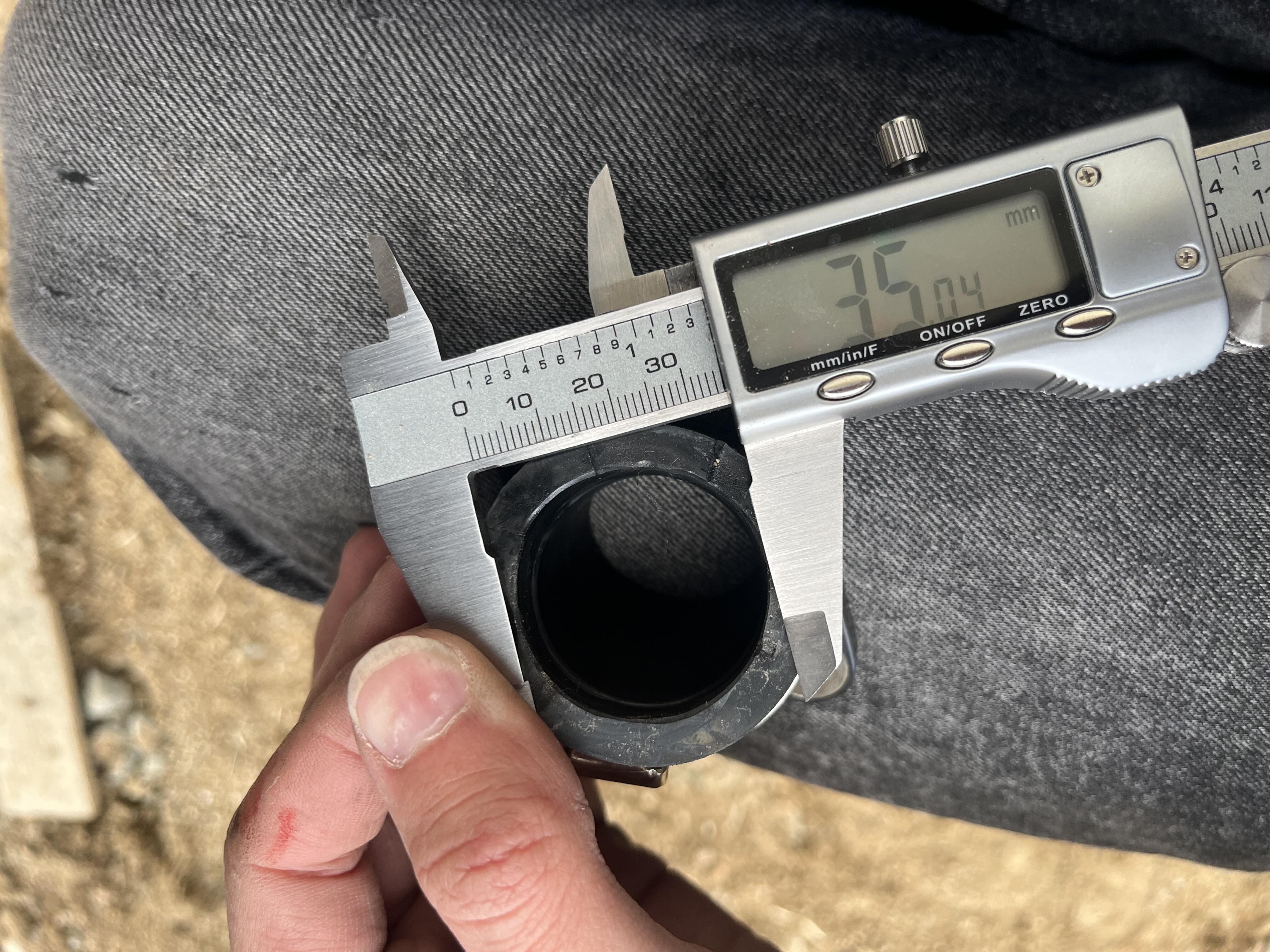

You were spot on!! Finally got around to taking off the boot and measuring it, and the link you shared is an exact fit! Engine side opening is 30mm, the bolt spacing is 61mm, and the carb side opening is 35mm. Thanks!

Thought I'd tag you since I got around to measuring the boot. The amazon link K'hermiit shared was an exact fit and I have the boot measurements in the comment above. Just an FYI. Thanks!
