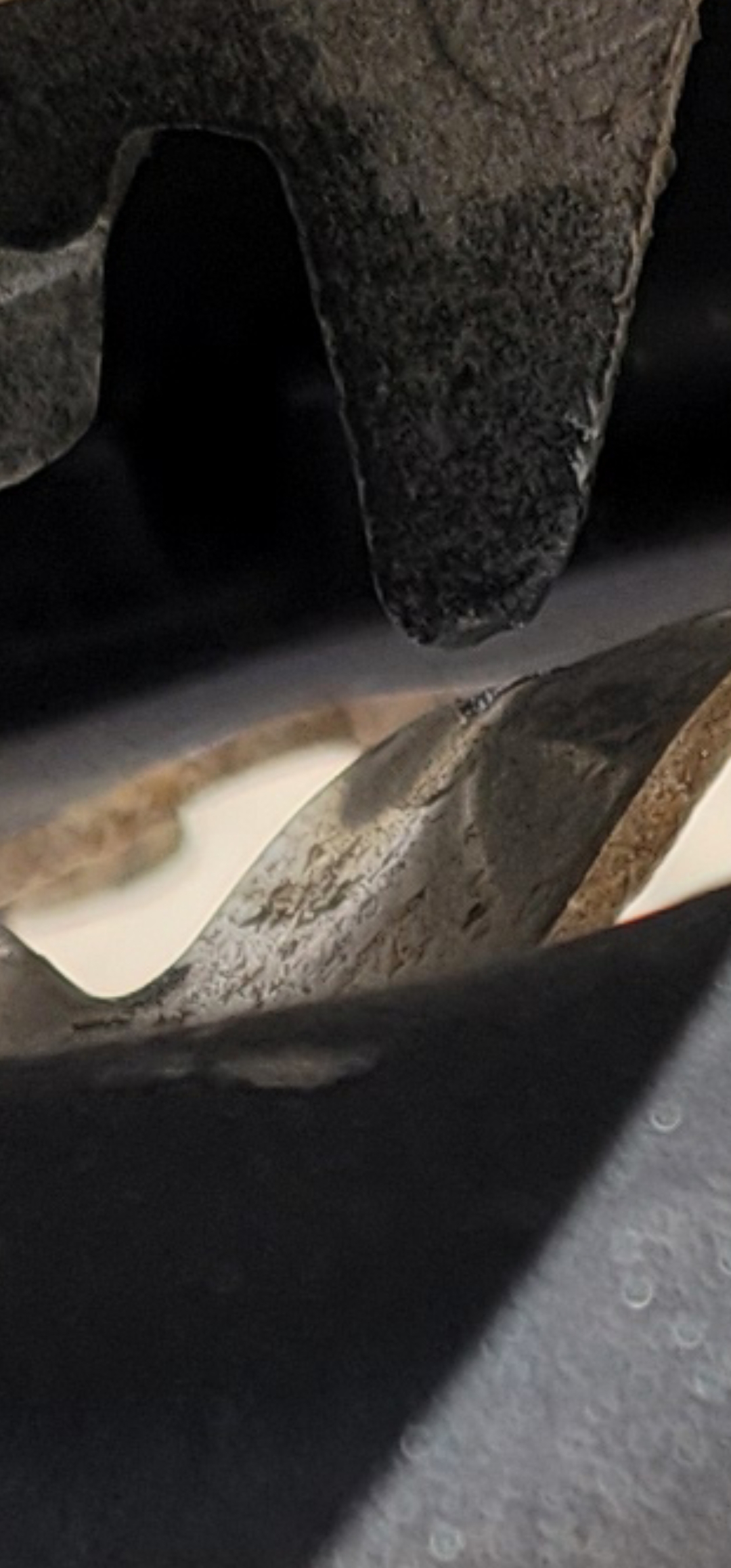

So the stock skidplate while thin probably saved me today. Large flat rock tilted up lifted the bike a bit while traveling slowly in 2nd gear. Skid is thrashed and did contact the case boss for the drain bolt. No leaking so far, fingers crossed.

Glad everything is okay. Others have downplayed the bash guard on there but I think it's pretty reasonable especially when considering how beefy the frame is and the purpose of the bike.

Consider it an opportunity to upgrade your bash plate lol
