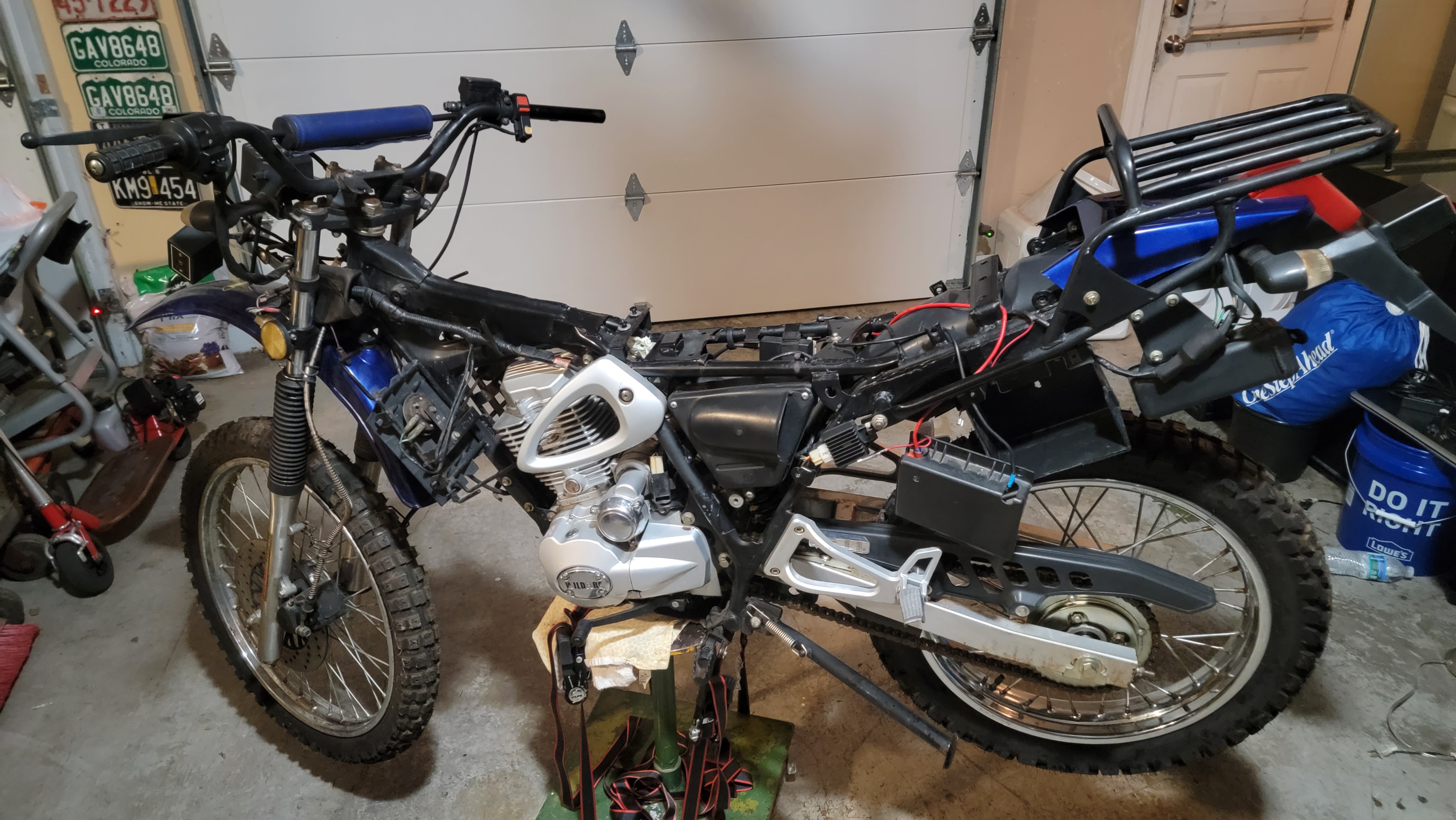

Just bought a 2008 "Hondoid" WFG-200LDB "Street Legal" bike w title here in TN and finding that it's a challenge getting the right parts for it. Any advice is appreciated thx.
My bike was basically leftover stock from a dealer and never really ridden - had 3 miles on it and title had never been signed over from dealer so it is blank.
Mine needs new ignition and tank lid (keys lost) - found the ignition but the plastic tank is weird and does not have a typical screw cap.
Will try to post some parts questions in the appropriate forums.

Nice deal! And welcome to C-riders
This looks like a 163-FM style pushrod engine. It is a good dependable Honda CG clone. Cleveland Cycle werks used this and derivatives on their creations. Verify the model (behind the gearshift. Presumably the engine/stator are OK, but knowing the engine model would be good.
Ignition? You mean the keyed switch, right?
Does the CDI unit have a part number on it? It may have a DC or AC type CDI unit. AC units get no power when you turn on the key. DC units get 12V at the CDI when you turn on the key.
Interesting battery placement back there! Can you get the battery to hold enough charge to see if the CDI unit is getting power when you turn on the ignition?
If the battery can hold some charge, see which lead at the ignition switch is getting power when the battery is connected, then jump it to the lead that goes to the CDI unit if it does (DC type CDI).

@Thumper thx very much - I have the keyed switch off and a new one on but noticed the 4 pin replacement is also male so I am having to crimp on a new female connector and realign those pins. I am pretty slow at electrics so just takes me longer to figure out.
This has just been sitting in a barn for a lot of yrs so some of the plastics and rubber grommets are just breaking down now. Some of the wiring looks sketchy too.
I will look for some of those parts numbers next.
Also saw reference to these being same or similar to Kinroad XT200GY so if that is a hint on what to search for will add that to my sourcing notes.

The only other bike I have seen w that same rear battery box is the Kinroad XT200Gy
https://www.china-parts.co.uk/acatal..._Explorer.html (out of stock)
Problem is the battery I got is slightly too big, so I am thinking I may just fabricate something from metal that will be stronger and all metal
