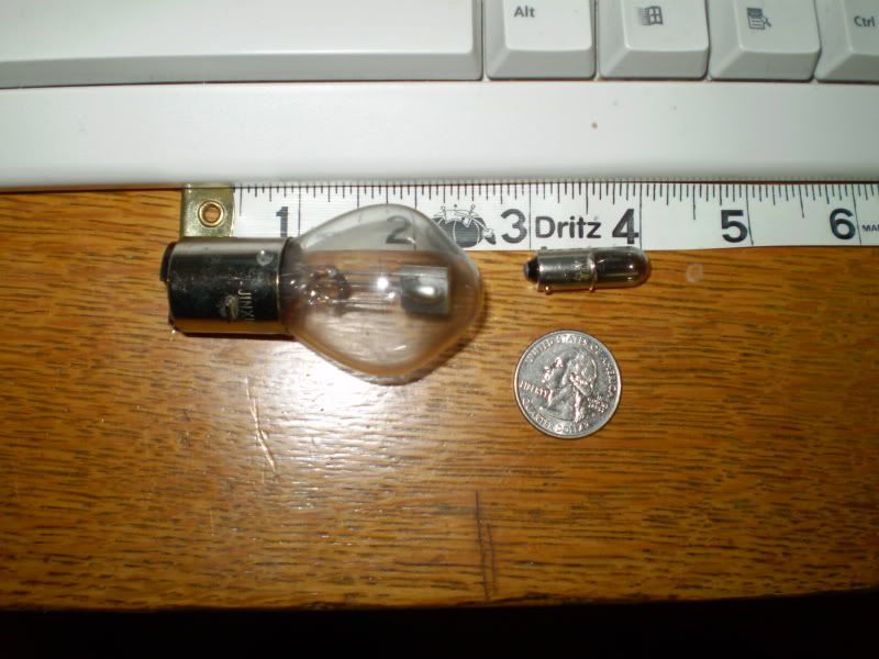

can you post a picture with something in the background for size maybe a ruler i most likely have them

Here's the ones from my bike.
May be different that what you need (Since everything is so "standard" on these China bikes) :roll:
I changed my headlight over to a 45/45w halogen H-4 base. Bulbs easier to find and better light.
Originally Posted by Stauffer
JINXIA NJ 12V 35W
Is this your bulb?? This one is a dual element, hi-lo bulb.
Bulbster.com
I buy my bulbs from this site.
the little one 12V 5W
Sylvania Lamp Part No. 1891
Found 'em at Advance Auto Parts. $3 for a pair.
Good luck,
Bill

Your headlight uses a BA20D lamp. I bought a ten pack of 45W/45W bulbs from the following vendor for $21.99, delivered.
http://www.lightbulbemporium.com/eiko_48058ek_6245b.asp
These 45W bulbs are noticeably brighter than the standard, 35W bulbs. If you need a BA20D bulb right away, check the local scooter shops.

i have the bigger bulb and i have a couple of maybes on the smaller one if you would call me or pm me your adress i think the big bulb runs a couple of bucks
