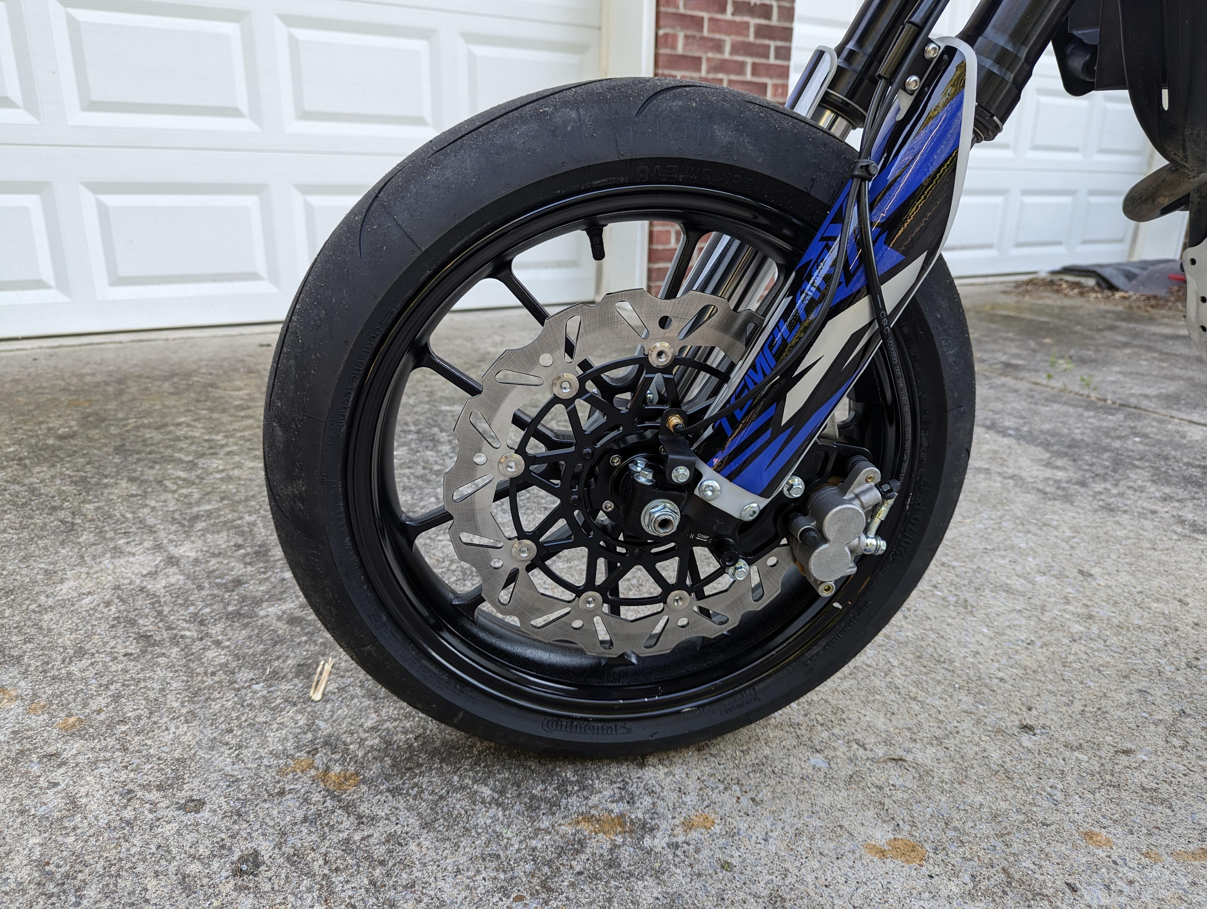

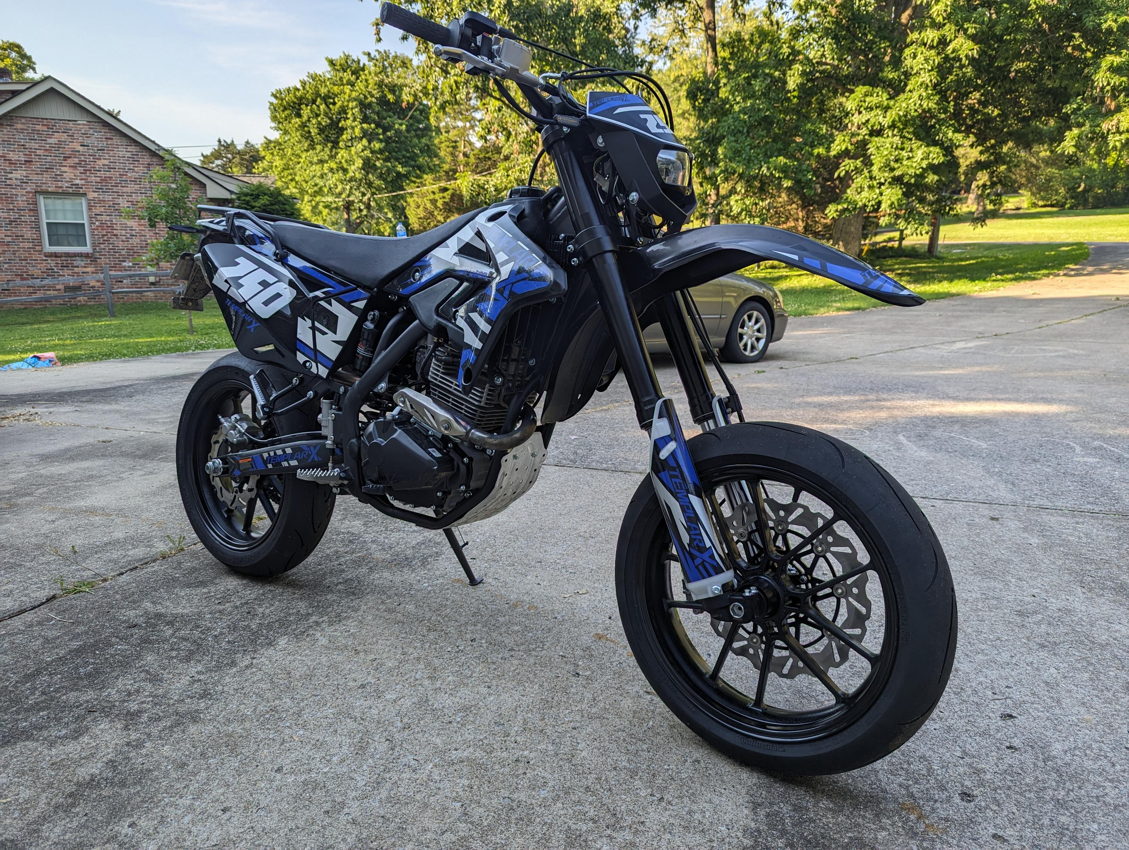

Hey guys, haven't posted in awhile, but I finally got some free time and did a SuperMoto conversion on my Templar X. I love it. It's a lot more fun on the street now. Can still swap back to dirt setup in 20-30 minutes. Have all white plastics for it too but haven't gotten around to installing them yet. Still need to shave down the front fender a bit for the sumo setup as it's a little long but doesn't look too bad.

Nice conversion. Love the wheels! And tires!
The front fender comes of with 4 bolts. You can get a different super motard fender and your conversion will take another 5 minutes. Maybe something you can clamp to the fork down lower? White....

I've had an eye for a set of "street" wheels and tires for mine. Not full motard, just a swap out set. What wheels did you find that fit? More details on that front disc would be nice too.
I second Thumper's low mount fender idea for yours.

The hubs and brakes from the Templar X are Honda clones. I bought those wheels for a 2004-2013 CRF 250r. I went with the cast wheels instead of the traditional spoked set because they included a cush drive and were cheap. They are 17" front and rear. The front rotor is 320mm with adapter bracket to move the caliper so that it fits in the wheel. That setup is for 2004-2013 Honda CRF 250r as well. Was just expecting better anti-fade properties from the larger rotor, but have been pleased to report much stronger bite as well.

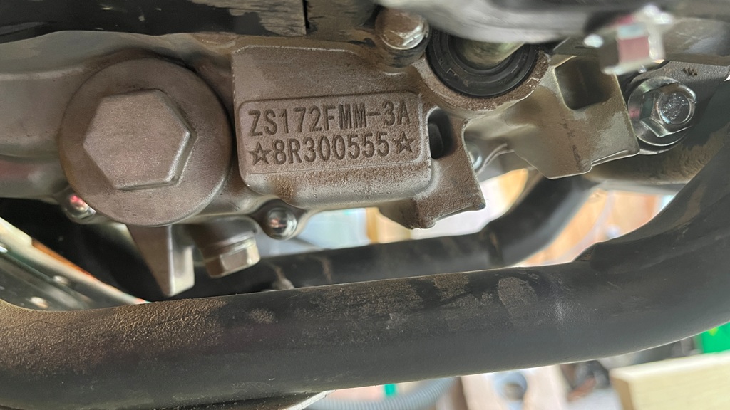

I just put together my new 2024 Templar-X 6 speed and noticed the engine says ZS172FMM-3A but the listing on Powersportsmax says ZS172FMM-5A, anyone know the difference. It is in fact a 6 speed.

I've had mine about a month. It also has the '-3A'.

I thought that they just had crankcases stamped 3A and decided to use them up with 6 speed builds, but NO, they persist with the 3A stamp. I really don't know why they aren't stamped "-5" which is what Zongshen designated the 6 speed (yeah I know, why not -6?)
Meh. Who cares. It has 6 gears and the counterbalance it pretty obvious!
Because CHINA
