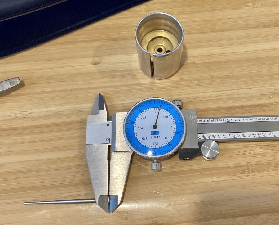

Needle is non-adjustable. This is the thickenss of the top of the needle permanantly affixed washer.
Attachment 27874

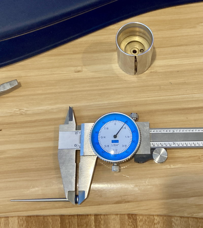

Now add a nitrile o-ring.
Attachment 27875
Not bad, just a hair thicker than the original, just a hair over 1mm additional lift on the needle to richen it up.

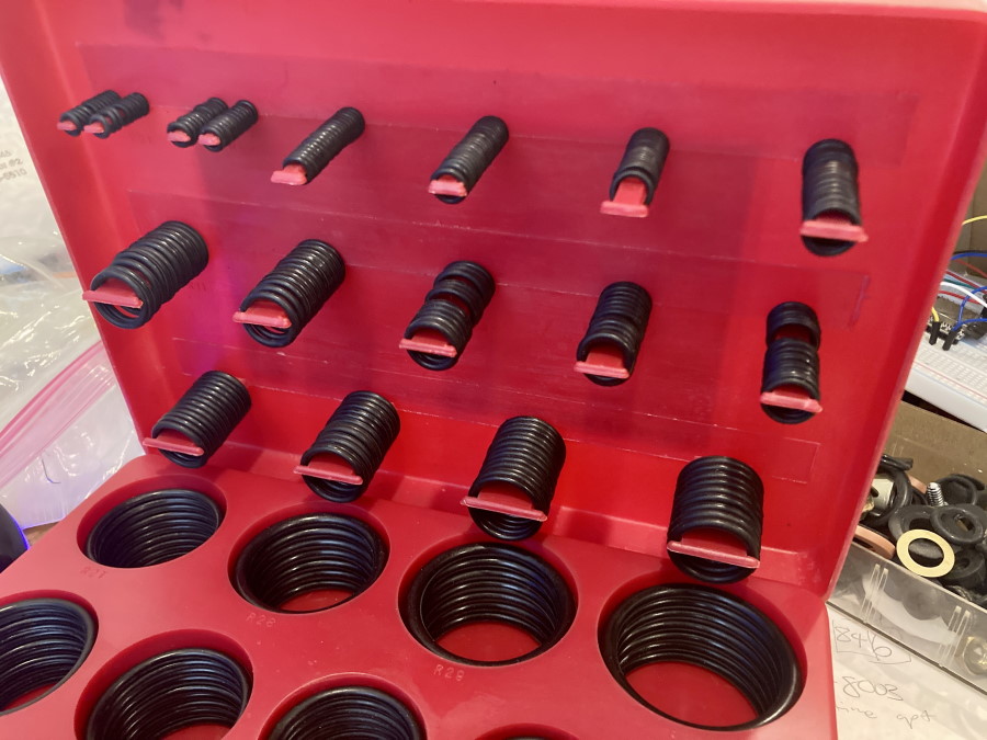

I used the smallest washer in the box, top left corner.
Attachment 27876

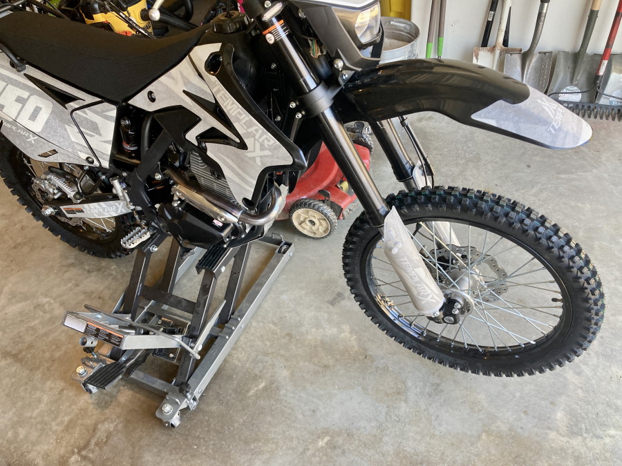

Today I dedicated to getting all the torque on the rear and front rim spokes dialed in.
First I got the bike racked so the front and rear tires could free spin.

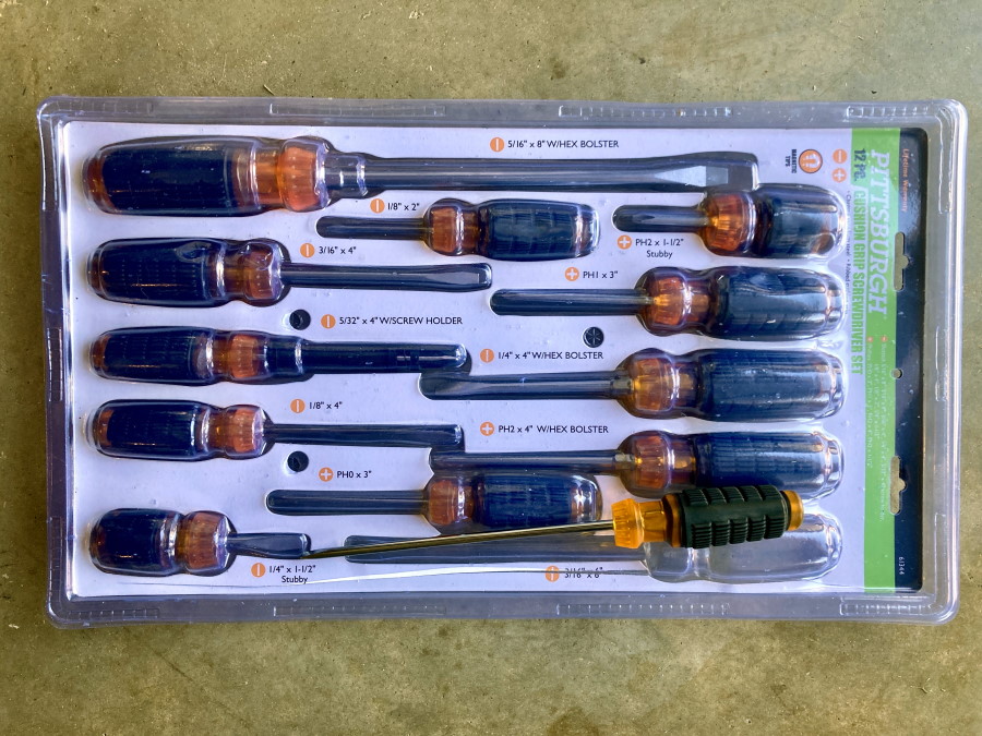

The price of threadlocker has gone up a bit since I last bought some so I went to my local Harbor Freight to switch brands.
I picked up both blue and red threadlocker at 1/4 of the price of loctite.
While I was there I had the idea of buying a Stubby Screwdriver and then grinding the flat blade size down to fit the Air Pilot screw I just recently freed up on my carburetor. To fit inside the frame I was then going to take an angle grinder with cutting disc and cut the handle side of the screwdriver mostly off leaving a short stub to grab and turn.
I decided against the single stubby screwdriver as a few dollar more and I could get the whole screwdriver set (one of HF's cheapest sets). I never bought one before and had always gotten the better sets.
I am so glad I did buy this instead!

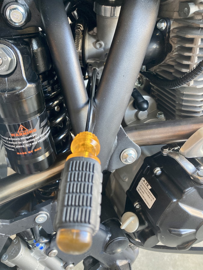

The very first screwdriver I took out on opening the pack I out of curiosity tried on the air pilot screw hole on the carburetor. Perfect fit! no work to do!
I love it when a plan works out better than I had planned it.
