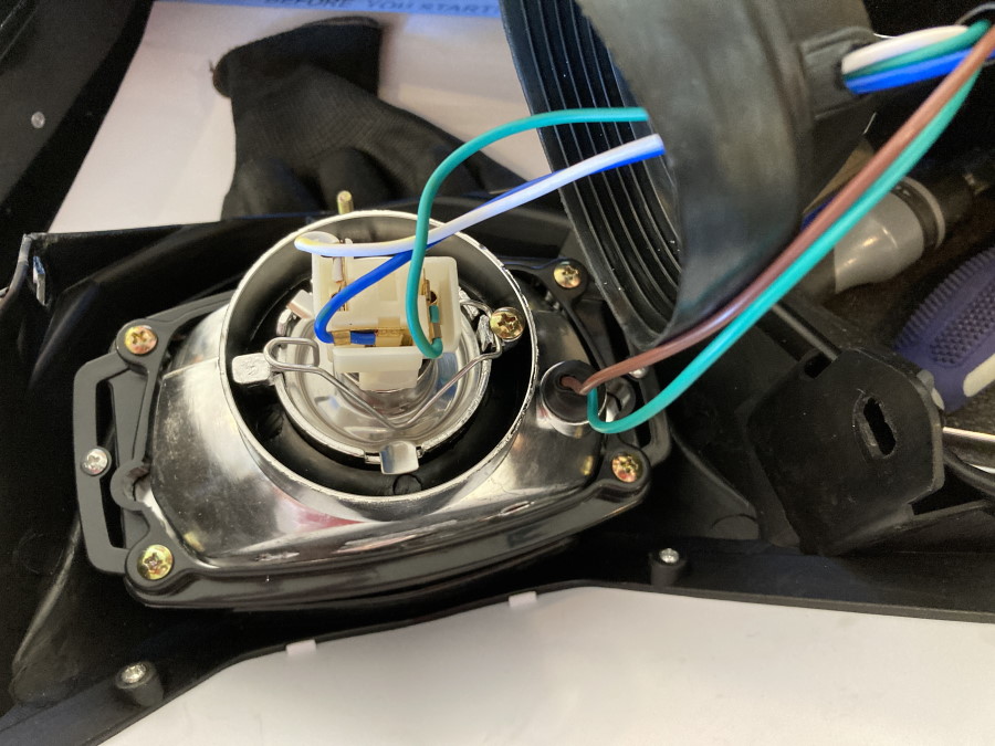

Focusing on the headlight bulb assembly the rear rubber did come off and is as suspected a waterproof boot.
Name:  Boot Comes Off Reveals Connector and Spring Lock.jpg
Behind the boot is a connector, that means a bulb that is replaceable to my mind.
Name:  Out Comes The H4 9003 Bulb.jpg
And low out comes a H4 9003 LED bulb! Absolutely no markings, no data, probably the cheapest H4 9003 LED that could be bought in bulk for OEM use. Likely not the full wattage limits for H4 9003 allowed on the roads here.
Name:  Lots Of Aluminum Passive Heat Sink.jpg
Lots of passive aluminum heat sink material. I note that some of these higher wattage replacement bulbs have active fan cooling, but the space behind the headlight assembly is tight with all the wires smooshed up against the back of the headlight bulb.
Name:  Three Prong Connector.jpg
Yep. Looks like a standard connector and it has alignment tabs. Why would that be... (to be continued)

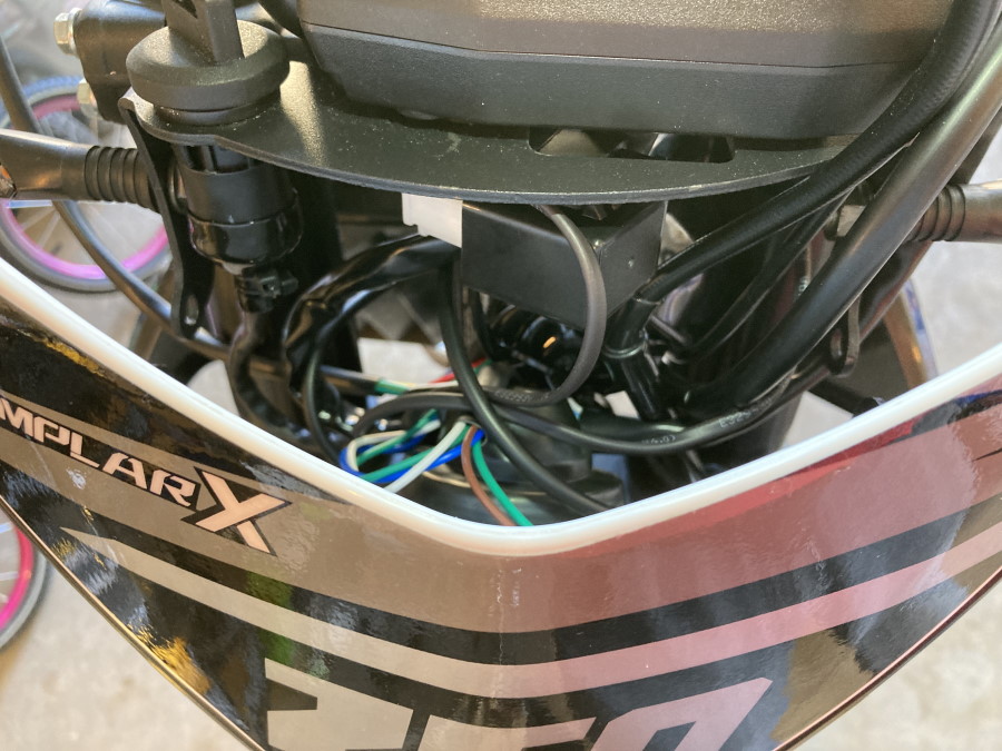

Time to clean up the cabling now that the headlight assembly is off
Now to the wiring bag that is jammed, smashed? stuck? against the plate. Here again its very tight behind the headlight assembly.

Finally I freed the bag, it was not stuck but jammed into the holder for the cables that run back to the engine (clutch and choke).
Now that it is free I can finally move the wiring bag all the way forward toward the headlight assembly which I have now done.
Name:  Wiring Bag Finally Freed From Blocking Plate.jpg
Now to reroute all the cables from the factory state they were in. This is the best configuration I came up with. I have fully freed up all visibility to the digital dash display.
Name:  Final Cable Rerouting Allows Full View Of Digital Dash.jpg
And the view from the riding position.

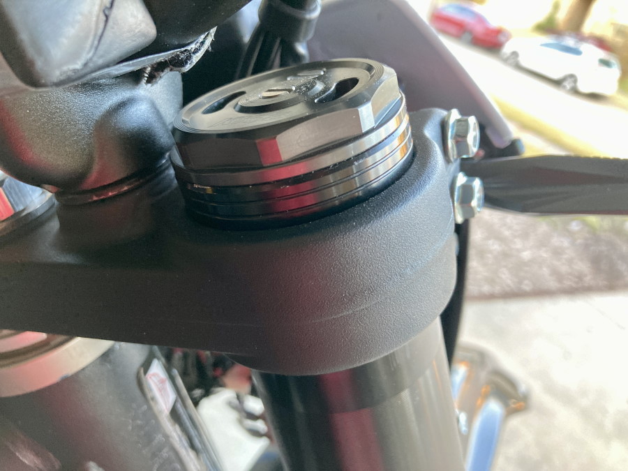

Suspension time
I decided to check the suspension on the bike and dial in defaults if it was not already done at the factory.
Turns out, it was not already done at the factory
I decided to read the click positions on the valve adjustments. Starting on the top of the forks, rebound.
Left fork turned in. 18 clicks.
Right fork turned in. 17 clicks. wait what?
try right again, back out, 17 clicks huh. Turn in, 17 clicks. I have different number of adjustment clicks on my forks for the rebound valves...
I dial them both 9 clicks out of in.....
Laying on the floor fork compression valves checked. Again all the way out on both. 12 click positions on both. I set them both 6 clicks out of in...
Rear shock, 12 clicks, again set 6 out of in...
A good starting position.
Now for sag, erm. I have no idea how I'd get a shock wrench in there let alone have room to swing it. Looks like I will have to resort to screwdriver and rubber mallet. How cave man... on second though I'll leave it alone for now and adjust later in case I come up with any better ideas.
Back to front forks, rake angle. Reduced it by three bars from my original default setting of full on chopper style all the way to the top. I've riding the bike today and have a feel for how it handles with the longer wheelbase/rake. I'll test ride it tommorrow to get a feel for how this works on the street when normally it is adjusted for race track conditions on the dirt on a given day.
EDIT: Adjusting this will also affect the sag setting for those that want to dial that in perhaps do that after any changes here.

The low beam on my bike shines about right. But when I put it on high it shines up in the trees. About 11 o’clock. Do you think I should flip the bulb over? Is that possible?
Old 11-30-2022, 10:33 AM   #866
It is not possible. The bulb has the three prongs as a key to prevent the bulb being installed upside down.
There is a small springed and long brass adjustment bolt and nut that should let you dial in the overal vertical aim of the headlight.
Attachment 27980
EDIT: This is all testing on street.
What a difference the rake angle made.
At the top of the forks with no bars showing my personal bike rides more like a chopper. It is more squirrely and more wanting to turn, a bit too twitchy for my liking.
Three bars down the bike is extremely planted feeling. Harder to turn. A bit too much for me.
So my journey continues towards somewhere inbetween the two settings to dial in my own personal preference.
Attachment 27979
Ok, this caused a throttle cable issue. I move the wiring bag forward after freeing it up so now the space immediately behind the headlight assembly is full of wiring bag now. The throttle cable was laying over top and now when turning the handlebars right, binding and racing throttle. Not good.
It took me 3 different attempts at re-routing the cables to get the throttle cable free from any binding on full handlebar turns left and full handlebar turns right. That throttle cable is extremely short on my bike, only a hair of some free play in it, so on my bike getting the throttle cable routing set up is critical to have safe turning of handlebars while riding.
It doesn't look as pretty as in the final cleanup photo, but now its safe to ride without fear of unintended throttle up on turning.
