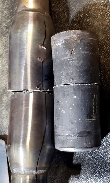

Thought I would post pics of a Templar x cat slit open and removed I found on FB. That thing has got to be restrictive.
They're rarely as restrictive as everyone thinks they are but removing it might free up a horse. More with a cam, porting, etc. I like the way it was done with a single cut. It makes it so much easier to keep perfect alignment when welded back together. Looks like I need a MIG welder and some practice pipe.

Whether it winds up being 1hp or 2hp from removing that cat, it is definitely felt in the seat of the pants as i can attest when the pipe was replaced on my Brozz. I look forward to doing it on the TempX.. wish they had a replacement header that fit on Amazon
