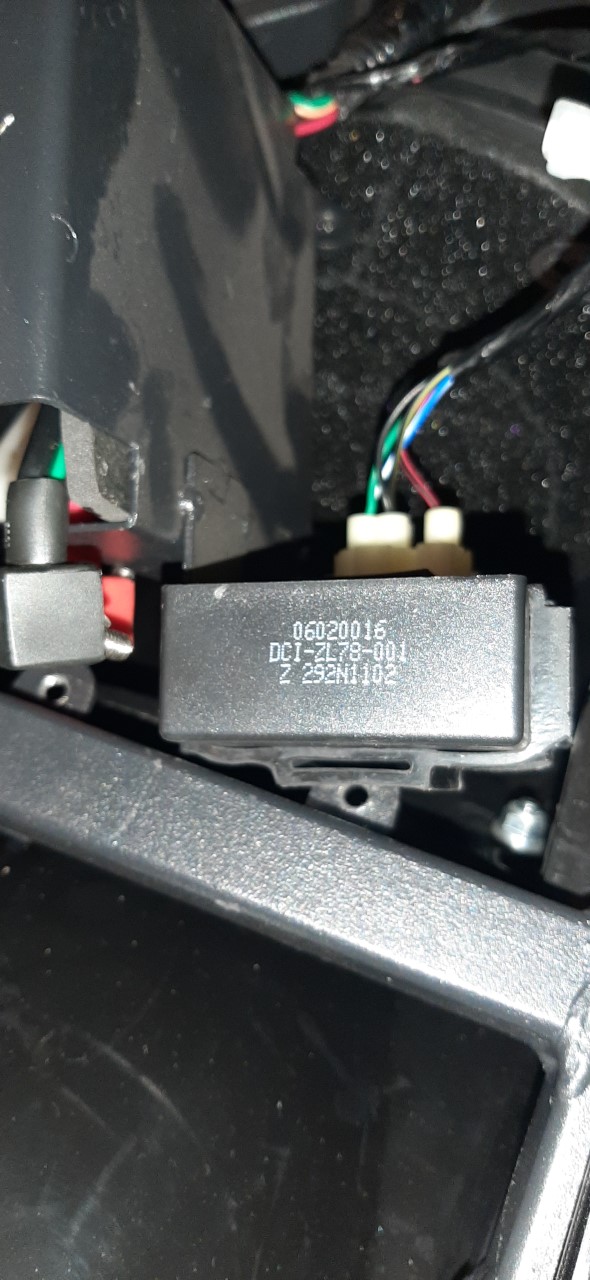

These are the numbers/letters on my 2023 6spd Templar cdi
I clicked the Powersportsmax.com banner at the top of the page, clicked "parts", then "250 dirtbike".
https://www.powersportsmax.com/produ...ducts_id/16760
The part that pops up sounds like it's used among many different engine sizes?
Templar X 250
Yamaha XSR900
Kawasaki Brute Force 750
Yamaha TT-R 50

Thanks Weeble. That is exactly the same markings on my 6 speed CDI unit, and the first three letters are "DCI", which I assumed meant CD ignition. And I verified it- YES, it is in fact a DC type CDI. I was just surprised that the 6 speed has a DC CDI unit since the 5 speed X has AC CDI. But it is a different engine, and this 6 speed is implemented on bikes with EFI, so that may be why (even though the CDI is integrated with the EFI module).
To verify, and before I ordered the DC CDI (which should be here today!), I tested the power in lead. Another surprise...ONE of the leads DOES get 13.2V (since my battery is charged!), but it is not the black/red wire suggested in the youtube video on the corner. It is in a different position on the CD unit in the 6 speed! It is the black wire in the middle position (no wire in the adjacent input on the twin connector).

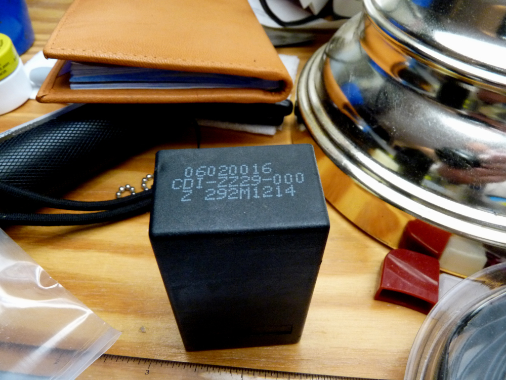

The original CDI from my 5speed X is in the parts box since I replaced it with the adjustable CDI. So I didn't have to take off the side plastic
Weeble's pic shows the one on the 6 speed had a part number beginning "DCI..." and it is indeed a DC unit (mine is identical). The one on the 5-speed sez "CDI..." and it was definitely an AC unit:

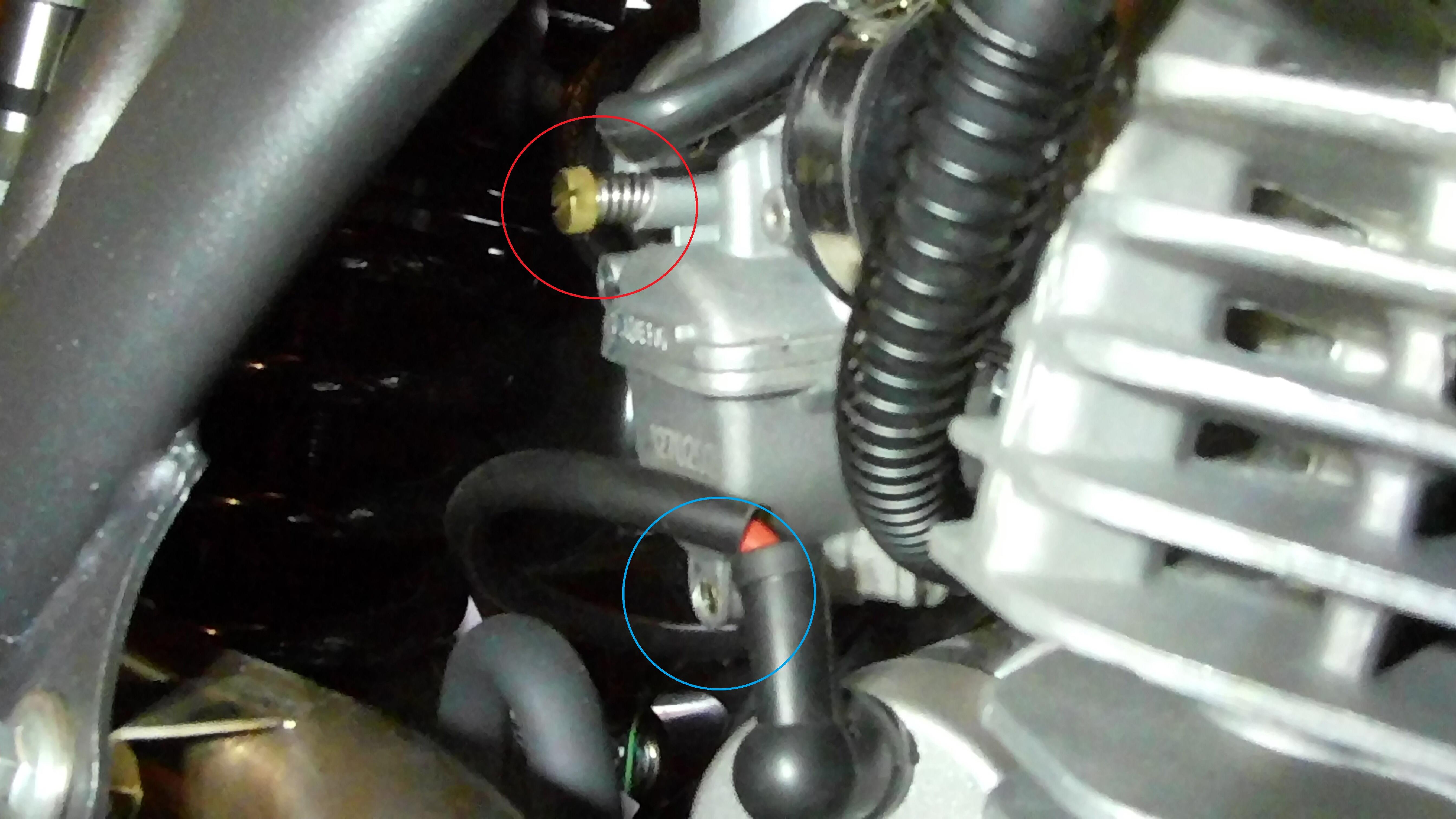

This is the first time I adjust a carb on bike. I adjust the one with red circle for idle speed fast/slow, is it correct? The engine ran a little lean, can I adjust the screw in blue circle to change air/fuel mixture. It's in a weird angle to stick a straight flathead screw driver and is very tight. Should I use a right-angled screw driver to turn it? Thanks again!
