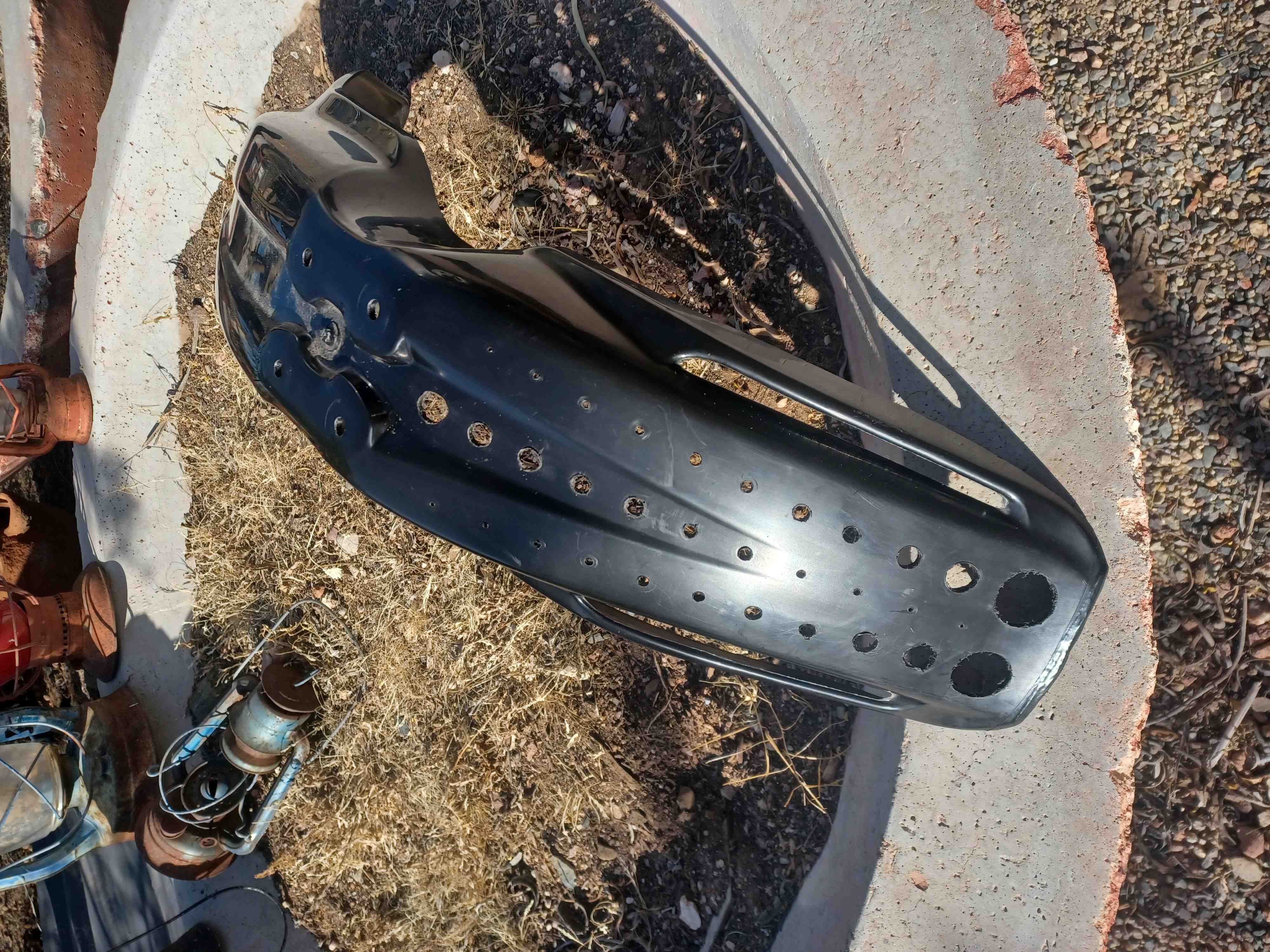

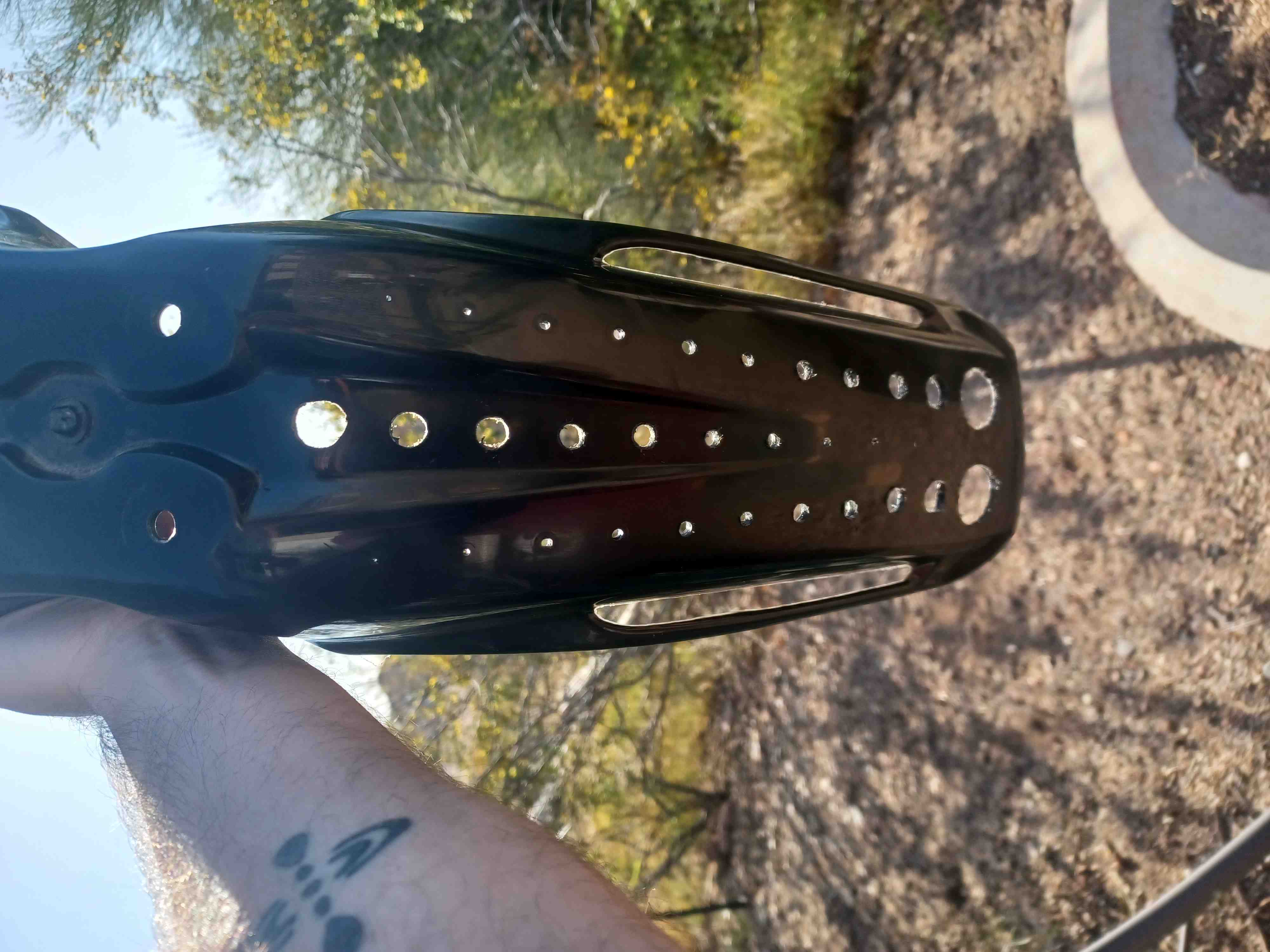

I saw aftermarket front fenders by Cycra that were vented and decided to do a little simple DIY project. I was worried about it looking like random swiss cheese so I took some time and came up with a pattern and I am pretty happy with how it turned out.
Being in AZ I am pretty concerned about heat, and I realize this going to do much honestly, maybe 1% improvement (if that); but it was fun and I think it also looks kinda cool.
I think the most of the holes are small enough to still provide protection from rocks, some mud will probably get through but that requires it to rain here

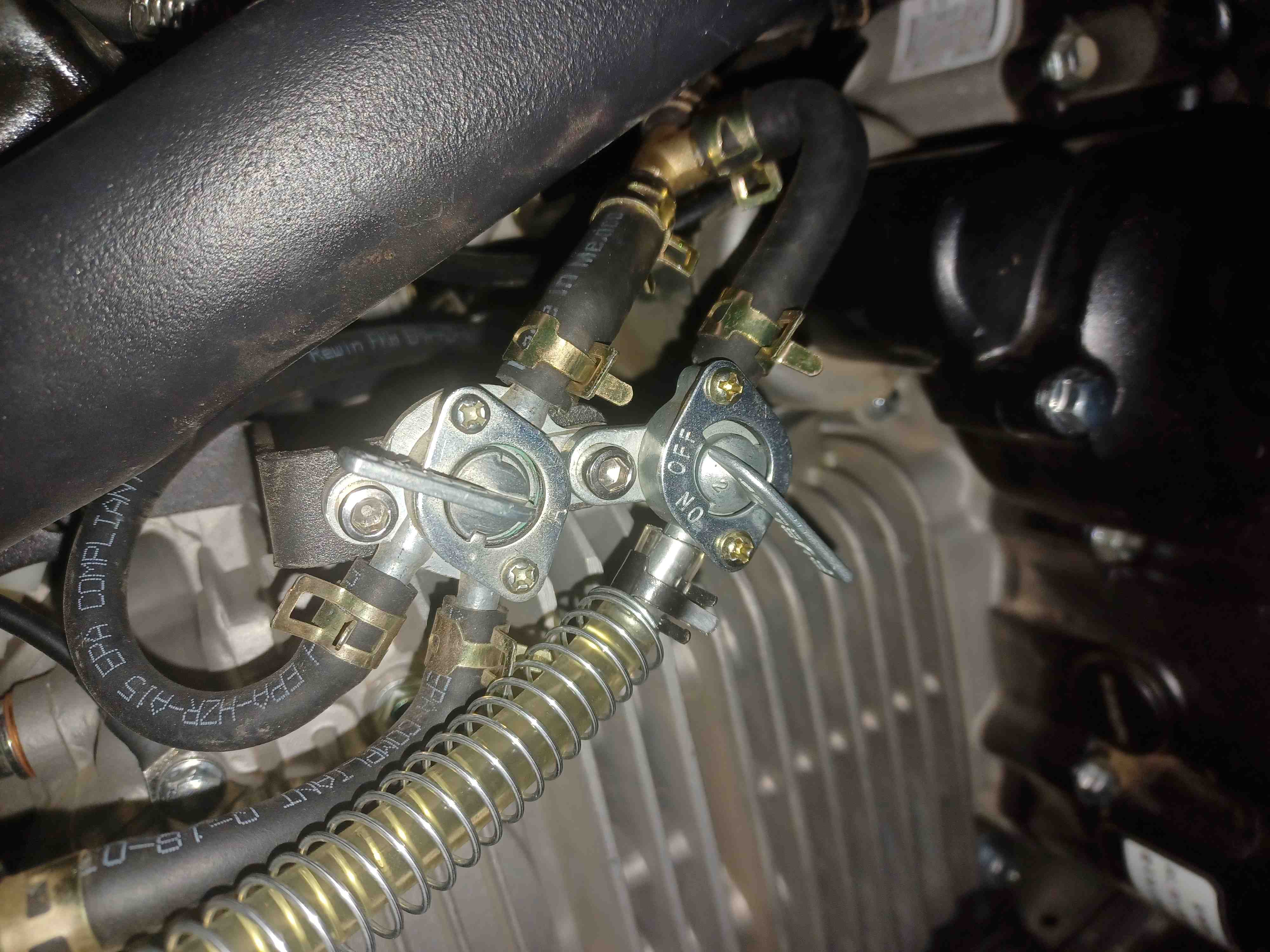

I was wanting some sort of fuel gauge, the best I could find online was by LSK https://www.lskelectronics.com/fuelgaugepro1 which is a really sleek looking setup, however $130 for a fuel gauge was not in the budget at this time.
Looking online more I saw gas tank sight glasses for motorcycles, but it required drilling of the tank which I wasn't going to do, and it got me to thinking about it and realized I could do it DIY style a lot cheaper. I tee'd off the fuel line after the petcock and before the filter and ran a line to a 2-way petcock and a clear line up to the vent line. I then installed a stainless steel spring protector.
I added the 2-way petcock as there is a lot of talk online of clear fuel lines hardening and cracking, so the petcock is there to prevent loss of fuel, I can just open the petcock to see my fuel level and then turn it back off. And it will be easy enough to swap the clear fuel line in the future as needed.

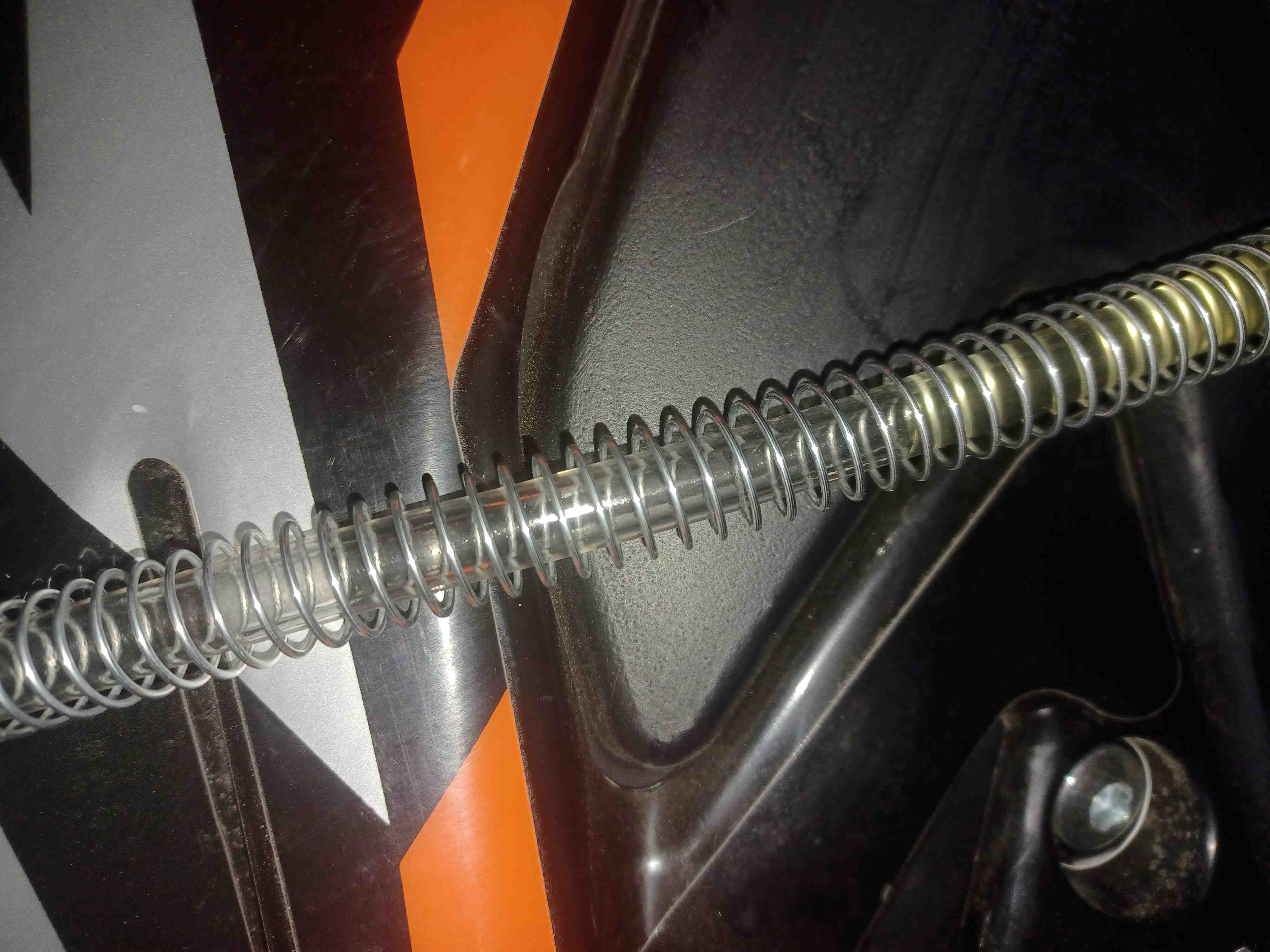

I am glad I went with the spring protector as when sitting on the bike my leg does touch this line and in general its a bit of a liability now, although that's one reason for the petcock on this setup. I may reroute it between the holes in the plastics in the future as this would move it away from my leg. After some riding well see about that one.

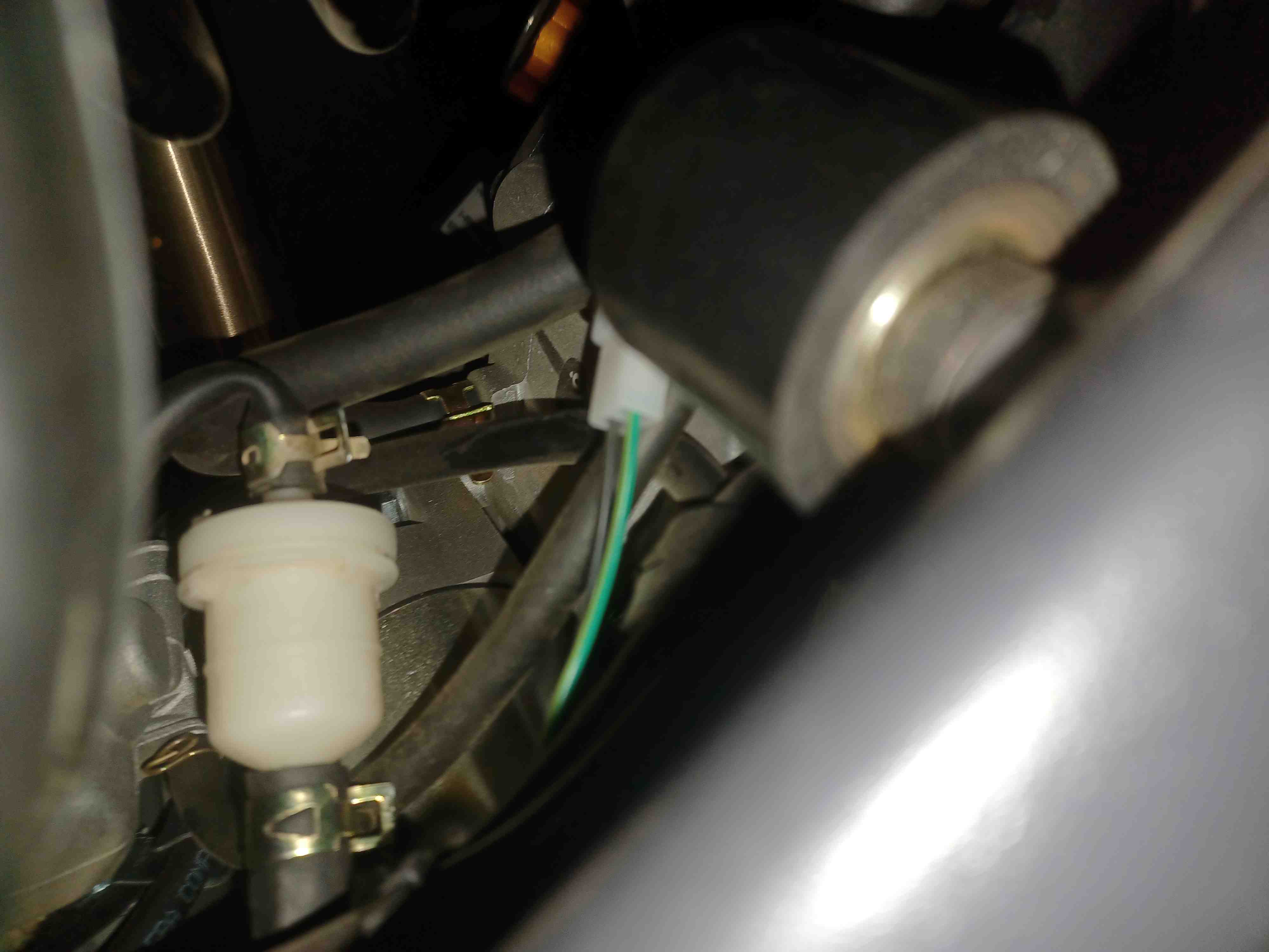

You will notice in the last picture adding that tee moved the fuel filter back and is somewhat pinching the fuel line after the filter now, so a 90deg fuel filter will be added in very soon to this setup.
Overall I am very happy with the outcome for now, its nice to be able to have some indication of fuel level.

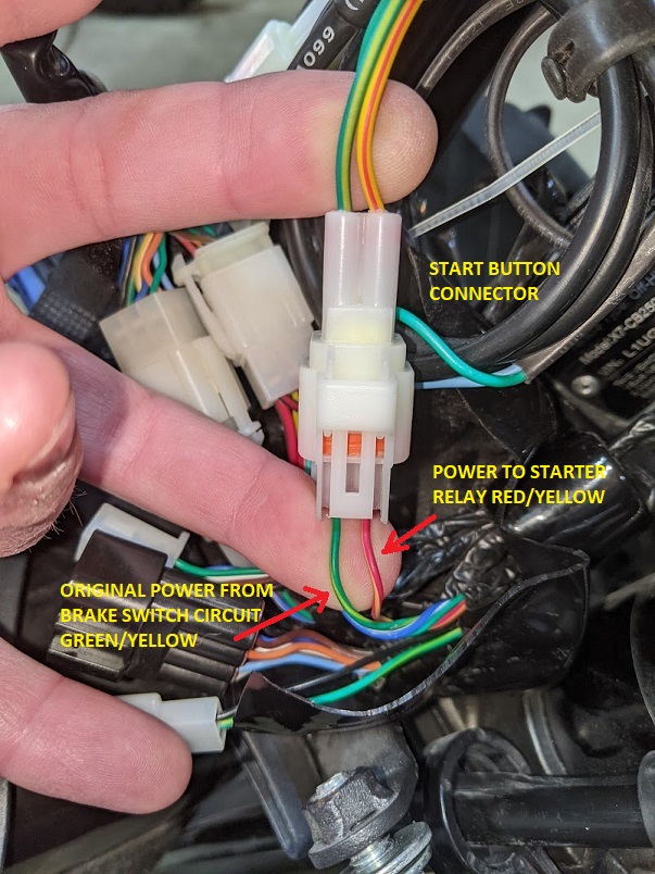

Originally Posted by Fast_Freddy View Post
I haven't verified this for fact but believe that the start button gets power from the brake light circuit. Depress either the front or rear brake lever and the starter button should have 12v to send to the starter relay.

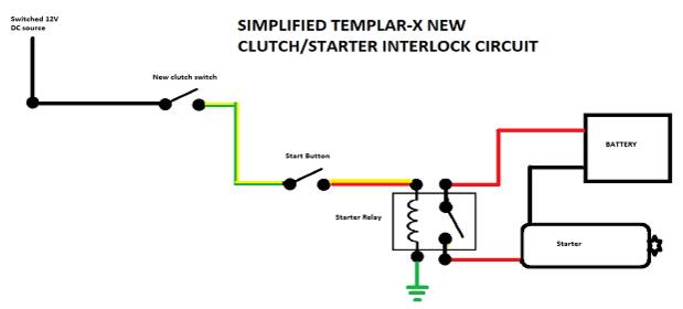

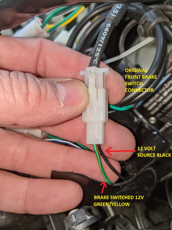

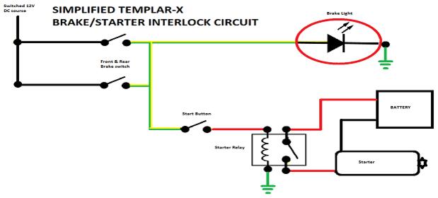

This is 100% verified and correct. Along with the lack of a full wiring diagram, the brake starter interlock is one of the biggest annoyances on the Templar-X. I have modified mine with a new clutch lever that incorporates a switch and rewired the interlock circuit. Attached are simplified diagrams of both stock and modified circuits and the OTOM OUDIMO-58958 clutch lever kit I used. It comes with a spare clutch cable and choke cable and is currently bargain priced on amazon. OUDIMO-58958
Also attached are photos of the relevant original neck harness wiring.
