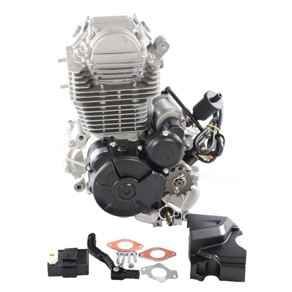

Originally Posted by Zooker89 View Post
Thumper, Have you done any more investigation into this? A guy who blew up his motor is asking...
It won't fit. Here is your direct replacement engine:
$519 from ebay

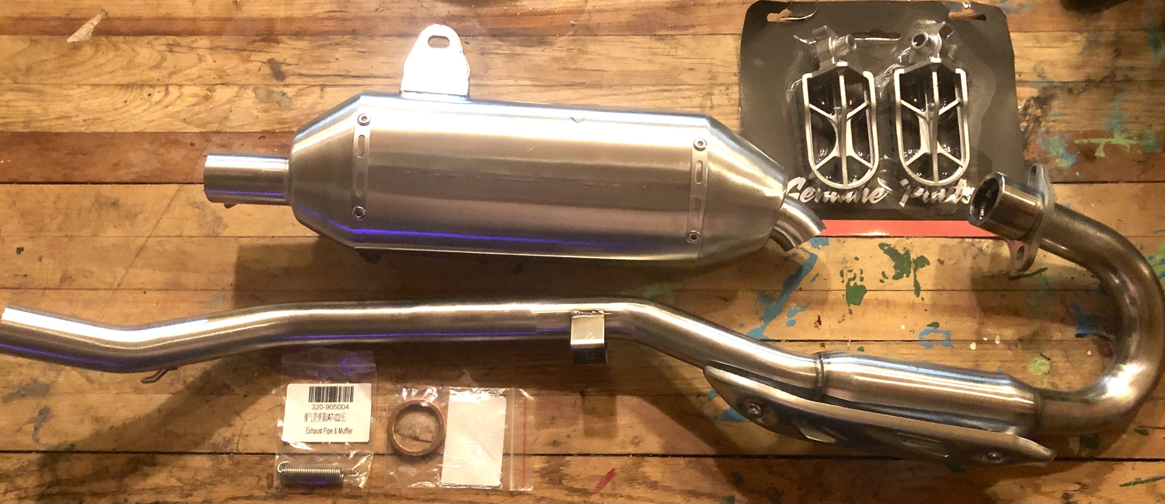

Whats up guys new to using forums but i have the new Templar X 250 6speed and its awesome besides shipping scuffs and the heat shield from the exhaust coming off from a simple tac job to fix im already at 900 miles and havent had a single issue and if you have one or the xpro titan 250 i have some brand new parts for sale if your interested if your warranty ran out brand new stainless exhaust system and foot pegs email me if interested ill give ya a good deal rathmanfamilyllc@gmail.com

What is the part number on that exhaust crush gasket? It's upside down in the pic !!!
Is that a replacement exhaust system for the Templar X?
Old 05-16-2023, 03:24 PM   #1333
Fyi: stock, there is no crush gasket, was ready to pop a spare one in but no-go
