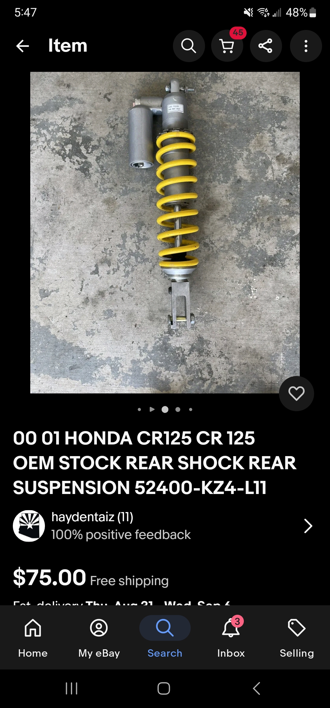

Something like this. Obviously would need a different spring but likely an endless list of compatible components.
