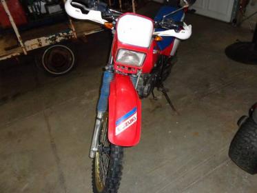

I bought a Suzuki SP200 dual sport
Well i waited and I was looking for a bigger dual sport and I had looked at a bunch of bikes.I got let down a bunch as I have high standards. I wanted something running and in good shape that had a title. I found this 1987 Suzuki SP200 .I must say I LOVE this bike , I think they had a guy in my size planned for this.This seat is the most comfortable I have ever sat on, new bike included. I looked at new bikes because I couldn't find one nice enough. I wanted an older bike because I think they are tougher ,I m sure Im wrong but it seems that way .This bike only has a couple big scratches but I love it.I like the colors as well I'm not one for yellow or green. Heres the most important part it has 7,138 miles on it and it runs fantastic it starts on the first kick and I don't use the decomp lever(Is This bad am i suppose to?). It runs so well makes 20.7 hp at 8500 rpm it says I believe it . I bought it from the son of the original owner . It had a clear title which I will go put in my name on mon or tues. Let me know if you know anything about them or have had one or have one.
