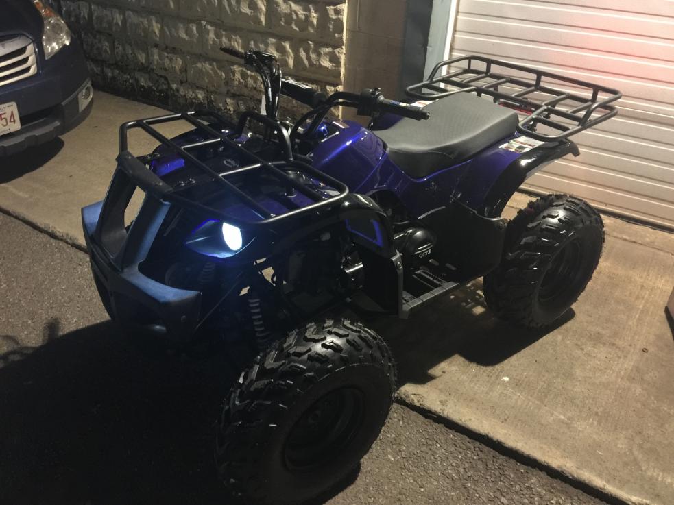

My name is Leon. I'm in Ashby Massachusetts in case anyone else is around. Kinda new to these "wheelers", I already have 2 110cc Coolster's, one bigger and one of the small ones. Today, my 150cc was delivered to my work. My boss was skeptical, but after seeing it, he wants one too...lol. Assembly went well by myself, from 3pm to 5:30. And that was uncrating to filling with gas and test ride. The frame of the crate had some damage and the bleeder screw for the rear brake was broken off and a couple scuffs here and there. Everything went together great. I do see some large rubber grommets that I couldn't figure out where they go. The smaller ones held the foot wells to the body. Next, I'm trying to figure out the hand guards.
Couple other things, if I wanted to add a small lightbar up front, where would I wire it up to? Direct to the battery with a switch? Second, I think the carb needs adjustment already as it dosent start on first crank... fires and dies- unless given a bit o' throttle. If just coasting around light throttle, it seems it wants to bog and die, then clears up... right around 1/8" to 1/4" of thumb applied. Any pointers on adjusting that?
Also, I have a ton of 5/30 Mobil 1 synthetic... can I run that? I think I saw 10w30
Thanks.

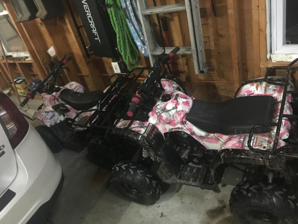

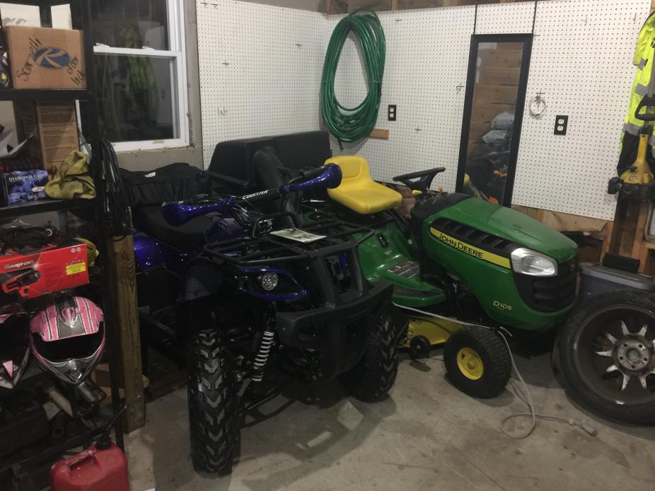

Fits neatly next to my grass eater...

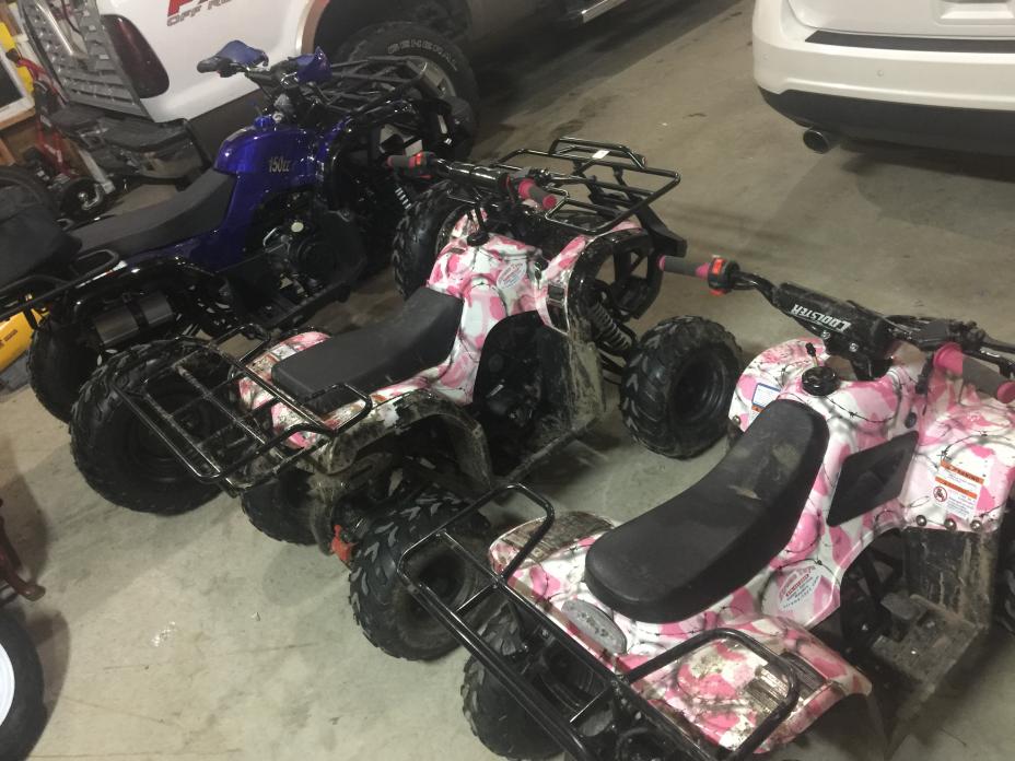

Swampy- My garage is 28x34 with two floors. Upstairs is a finished game room and big screen (SUPERBOWL! Go Pats!) Wouldn't mind an elevator to get stuff upstairs...lol. My mistake was forgetting to put my riding mower in the shed before the snow came... and the power washer... and the yard trailer/cart.
