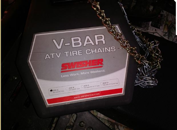

Bought real nice rear tire chains with an extra "V" griper on each link for around $40 off ebay, they look very aggressive, and I expect they will be a big help with snow plowing.

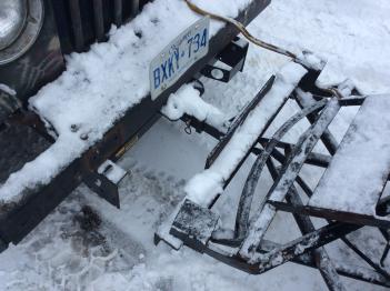

Whenever we run a winch for a Plow ,we remove most of the cable as it tends to bird nest real bad and fail often .Its a bit of a dance though as you want a few wraps on the drum to slow it down and give it some power,yet if the drum is full it creates issues .Also if I am not mistaken ,my friends from New Jersey typically deal with wet heavy snow ,why not just put a Plow on the Jeep ?I built this a few years ago and it worked perfectly but my feet in winter boots were causing clutch issues (not enough room ) so I sold it .

You're right about bird nesting, I actually tried using the winch to move an old hottub, and when I had my son hold the line to keep tension as I reeled it back in, he had no clue and it got messed up. I ended up cutting it, so it is shorter now.
