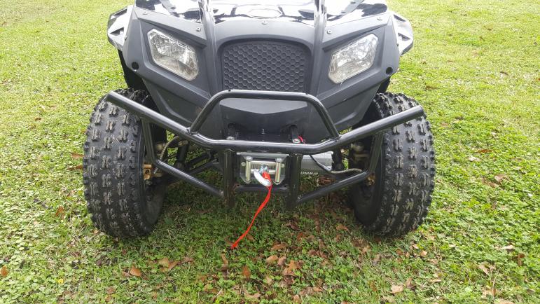

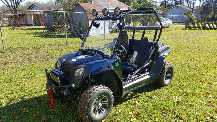

Here are a few pictures of 2500# Harbor Freight winch installed on my daughter's Cazador 180xl Saturday. I had to extend the bumper out a few inches. The install went pretty smooth.

That turned out pretty nice. Does it have more than just two bolts holding it on to the mount? It might just be the picture, but that is what it looks like. I would be worried about it snapping the bolts under torsion if the winch isn't straight on.

That base of the winch only has two mounting holes so I welded it on too.

Wow, what a terrible design. I guess since it is such a light weight winch they figured it was all it needed, but sheesh.

You would of thought the would of had at least 4 bolts. But for $50 It didn't surprise me. It is a pretty good winch for the price. We tested it out it will drag the UTV sideways with very little effort. I'm going to wire in a manual switch too just in case the remote battery ever failed.

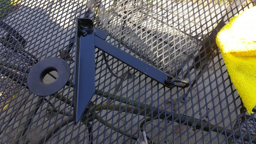

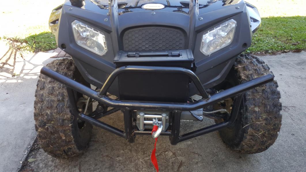

I got up early this morning and fabricated a land anchor out of flat bar and angle iron. I made it so it will fold up and fit in the ammo can. Places like the spillway doesn't have many trees to hook to so most will either carry pipe or rods they can drive in the ground or use a land anchor. The ground is soft and the anchor will dig it self deeper as you pull on it. After that I mounted an ammo can to store the anchor, tow strap and shackles.
